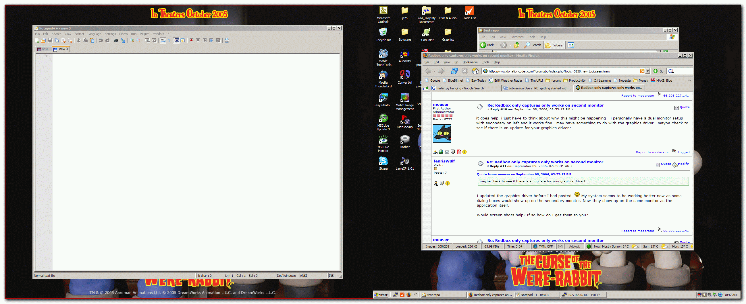

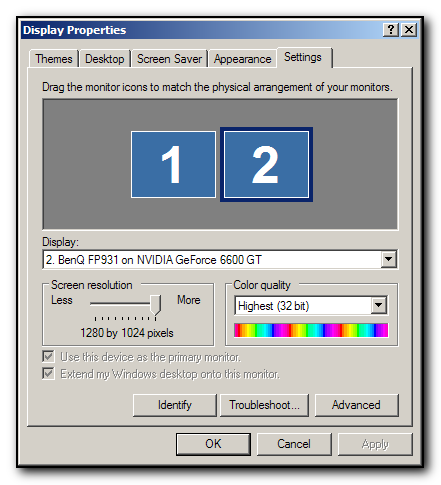

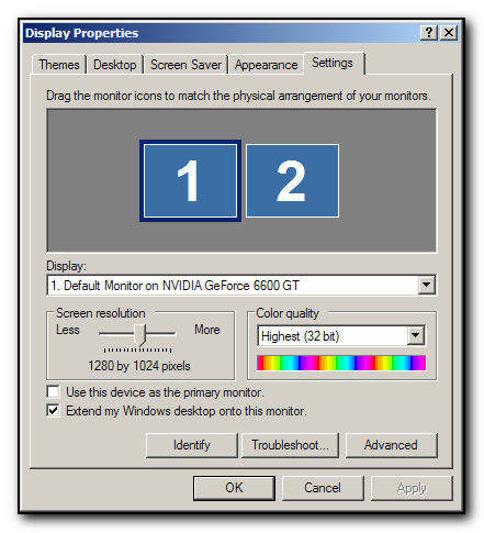

Here are some screen shots.
Display 1 and Display 2 are screen shots of my monitor properties (not sure if they are of any use). Full desktop is a shot illustrating how the redbox outlines the desktop of my secondary monitor but not of my primary.
