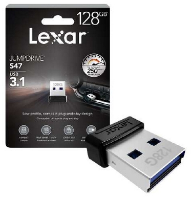

laptop has a couple of USB 3.0 slots and I do have a fast thumb drive that I've been using.  Of course it sticks out of the side, daring me to break it off.
Been there, made that mistake  >:(  Slots at the back of the laptop especially invite destruction.  Two possible palliatives; a right-angle-bend USB adaptor, and/or an extension cable, both cheap on eBay.
Low-profile USB sticks: the Lexar JumpDrive S47 USB 3.1 flash drive - 128GB costs £25.99 from 7DayShop in the UK.  YMMV.
