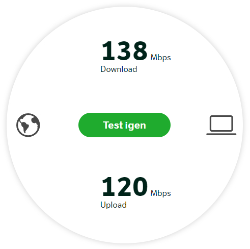

First off, I checked what my own IS (=Internet Supplier)'s speedtester (https://kundeservice.yousee.dk/bredbaand/loes-problem/hastighedstest) had to say: 138 Mbps down. Hm... that was a disapppointment by itself - not even close to the 300 I had been paying for, not to mention the new 1000!

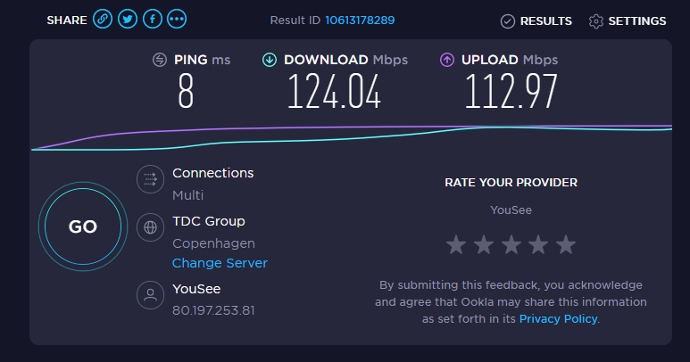

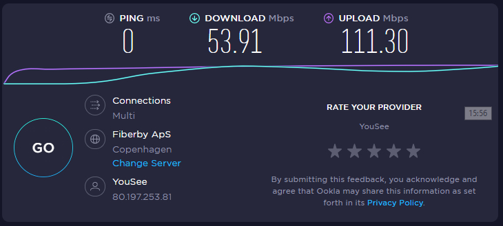

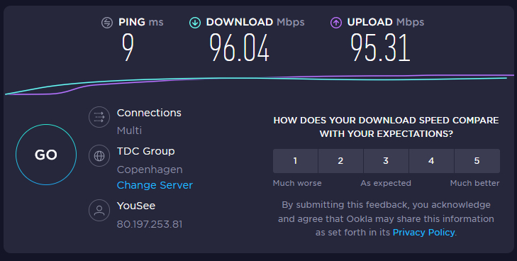

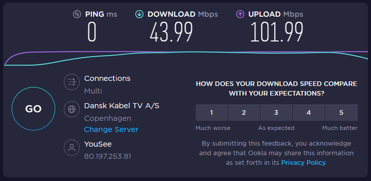

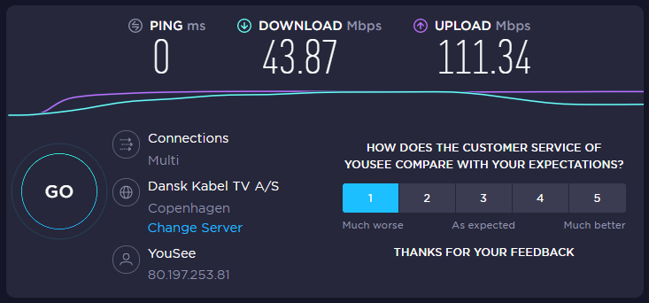

I downloaded a series of Internet browsers and tested them at once. By "at once", I mean: Download, install, run! No apps or settings of any kind, just paste https://www.speedtest.net/ >Enter >and click GO!
I was in shock: The results were all in the area of 43 - 124 Mbps. They should kiss a thousand !!!
Mbps:
Brave: 44
Opera: 44
Vivaldi: 54
Internet Expl: 97
Firefox: 108
Chrome: 124
2021-01-21_BRAVE.jpg2021-01-21_Opera.jpg2021-01-21_Vivaldi.jpg2021-01-21_Firefox.jpg124 speedtest.net Ookla.jpg

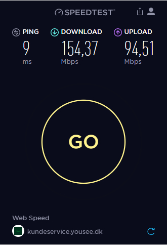

Later, an in-browser-app for Edge: 154MBps

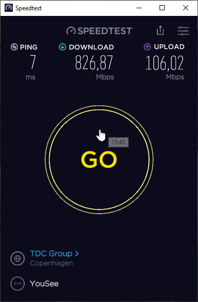

But then one of their technicians phoned me and asked eh... have you not tested with Ookla Speedtester's APP? You should! This was the first time I heard about it: an app for local speedtesting (https://www.speedtest.net/apps). I now have it (Speedtest by Ookla) and my online connection apparently is, as it should be (I have not fully reached a thousand, but almost): 826⁺Mbps

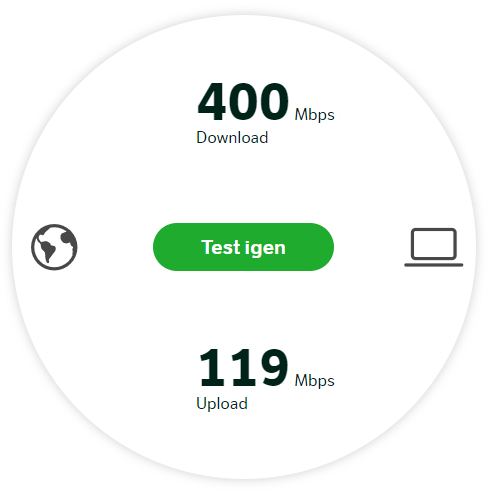

But of course, parts may not be working as expected. As an example, I realized last night that AdGuard still had a part running. When I closed it, the speed immediately rose to 400Mbps
Quite an improvement  :Thmbsup:
but still a long way from 820~1000

To start with I'd boot into Safe Mode with Networking, fire up Edge (or any browser with zero add-ons), and then do your speed test, (personally I'd use an ftp transfer but this is easier), so there'll be no extra background programs running.
If I'm following this right, (which is not normally the case as I get older ;D), you get 400Mbps on the computer, 800+Mbps on your phone (via WiFi) through the same router, modem, and ISP.
