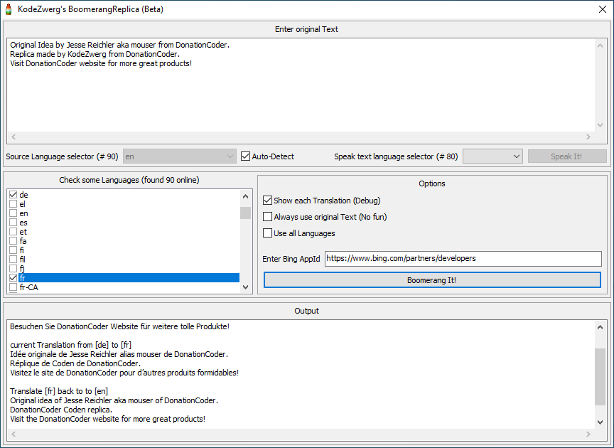

I do not know yet if I should release my Replica of Boomerang.
Thats how it look so far, begun yesterday to code it.

The problem will be how my app interact with translation api.
Those are the settings within my app that control the workflow.
But users will need to make a) Windows Live ID to make b) Bing API AppID. (my app need the Bing)
Further more, users must find out on own hows a good mix of shown options. (shown are my defaults)
...translation api is free for a few calls, not endless fun except you pay (not me! do not misunderstand that point!)
I guess in the end I have more problems to reply "how-to" "dont work" "what now" "why is it slow" etc questions than it is worth publishing.
At least the app works legal, I do not harm any TOS.
BTW I do have more fun listening "text-to-speak" than to actual translate ;-)
Example: English Text with Arabic vocals, so much fun hehehe
I might make a game of that feature "Guess the text" played at random vocals  :P
