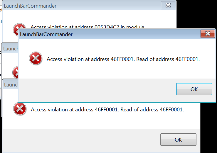

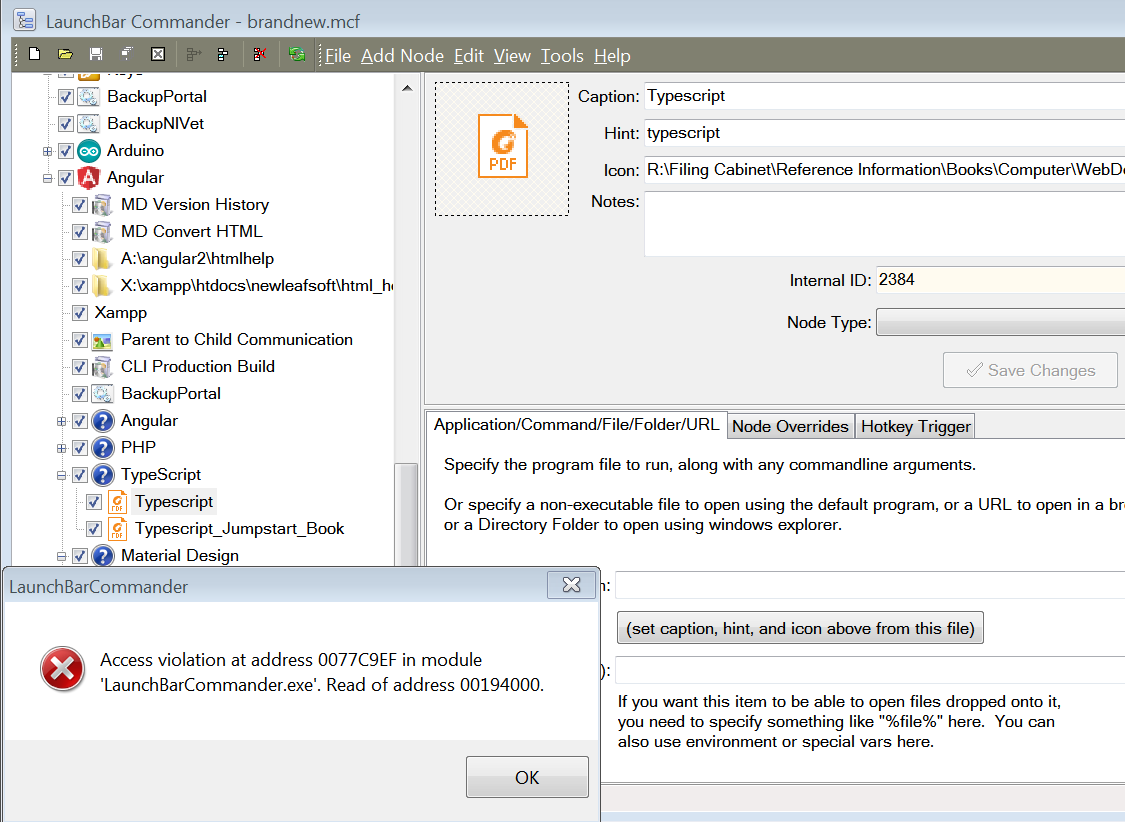

Hello reader,
I'm experiencing an error, see attached screenshot, that happens whenever I click on a node that is configured to open a PDF file. This happens only in Configure and Preferences window. In the launch window menu items that link to PDFs open perfectly.
The error prevents any new menu items pointing to PDFs from being created or edited, either by drag-drop or manually.
LBC used to work perfectly, hence in the screenshot you can see PDF menu items have been setup without errors. I do not remember the first time this error occured but it's been there for at least one year.
My PDF reader is the latest FoxitReader. OS is Windows 7 pro, x64.
I have exactly the same issue with a clean Windows 10 pro x64 installation.
Would really appreciate your help on this.

Sorry, somehow I missed this original post.
I can add a pdf node and click on it in configuration dialog without error.
Which makes me wonder if it's something about the pdf file or the configuration in LBC that is making it confused.  Still makes it an LBC fault but I need more clues to try to figure out the nature of the problem.
If you drop a new different pdf file (one made a different way ideally), onto the config, does it have the same problem?
In your photo the command path looks like its not set -- I wonder if that's a clue.
If you can figure out any more clues as to when this problem happens let me know.

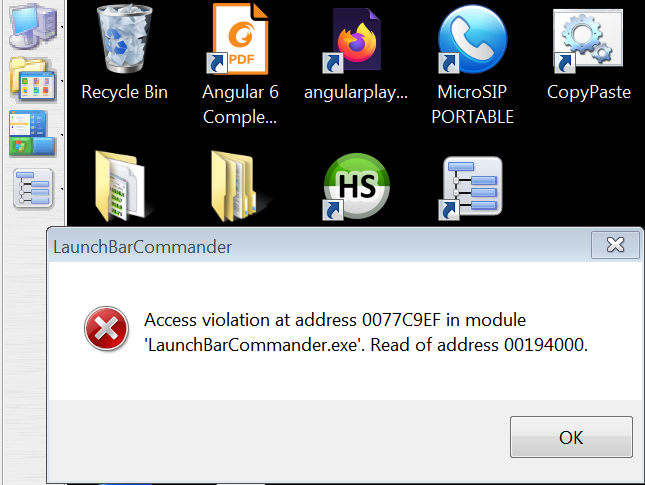

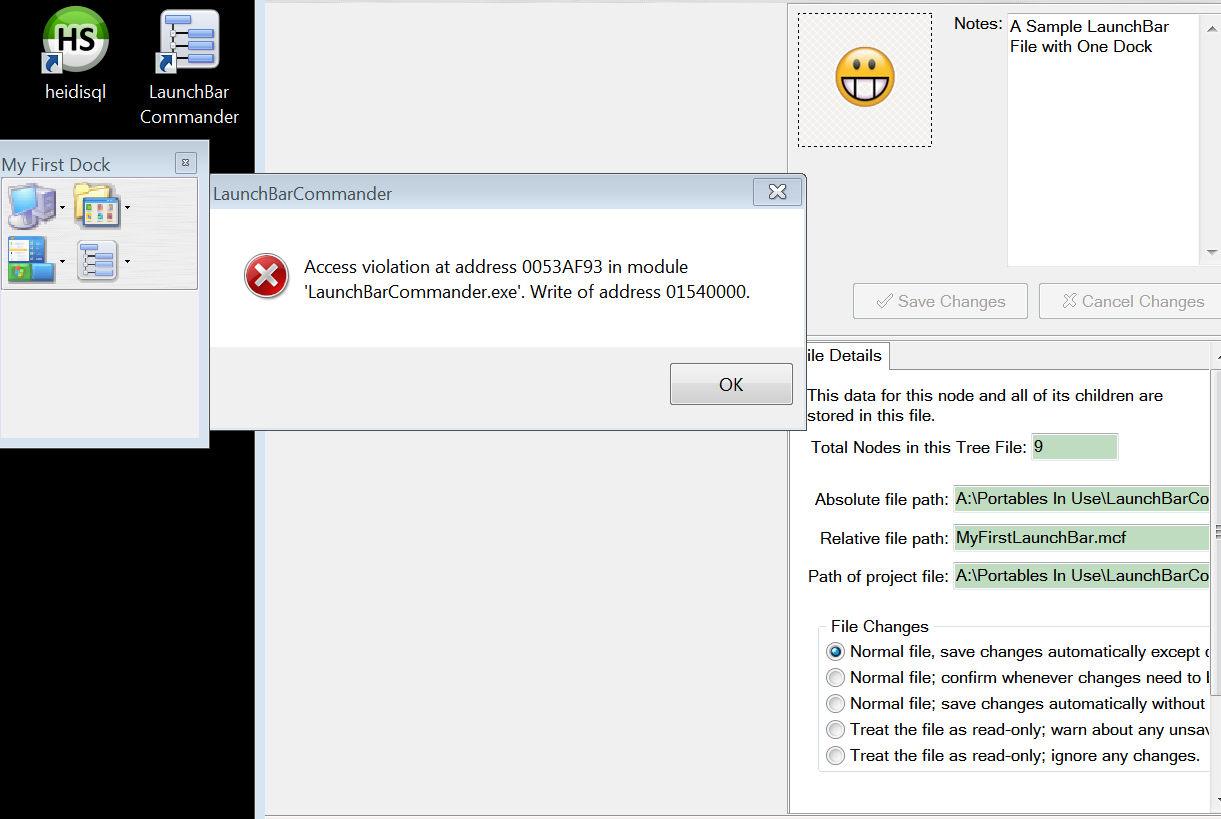

The good news is that the issue is simplified, the not so good is the same access violation occurs.
And you're using the latest version of LBC?
Yes, the latest. Installed with the setup in: "C:\Program Files(x86)\LaunchBarCommander"
Can you try this: download the portable version and unpack it somewhere and run it (exit your normal LBC); that will give you a new file.
Try dropping adding the pdfs to that new bar.  Let's see if it happens right from the start
Closed down existing LBC and installed/run the portable version. Dropped a known good PDF onto the default bar (not via config. window), immediately the same access violation - see below.
Did the same onto the config tree, a different access violation and the tree window pane grays out - see second attachement.
Tried dropping text files, got the same access violation. Tried dropping exe files, works perfectly.
I can't blame my Windows 7 pro because the same error appears with a newly installed windows 10 installation. Can any hints be gained from the access violation address?

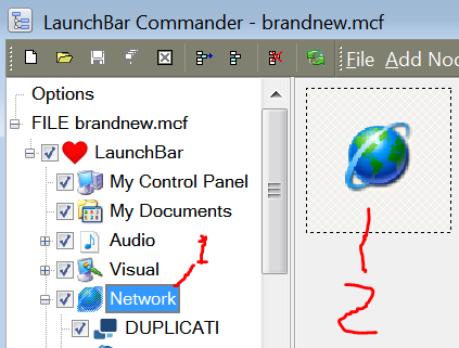

Can you try this for me just to see if it gives any more clues:
Open up your LBC configuration and select some node you don't care about.
Now drag and drop a file onto the ICON IMAGE.. Normally this has LBC replace the node icon with the one representing the file you've dropped.  I'm just curious if that also causes an error when you drop pdf/text files onto it.
I wasn't sure which icon to drop on so I dropped on both '1' and '2' in the image below.
1 - dropping exe file here inserted a child node under 'Network' without errors. Dropping a pdf as previously stated gives the error.
2- dropping exe file on the world icon gives the same access violation with the address as in the image below.
I've downloaded the debug version and will give feedback tomorrow morning (Australia). Many thanks for following up on this.

Sorry, the wrong image showing what I meant by '1 and 2' got uploaded, tried again...
