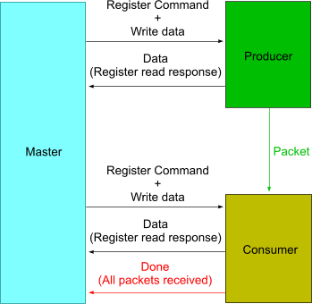

This is an example of an untimed simulation of 3 modules: Master, Producer and Consumer.
The Master programs the Producer to send a given number of packets to the Consumer, and the Consumer to expect that many packets from the Producer. Once the Consumer received the said packets, it sends a Done signal to the Master, which then either repeats the cycle or ends the simulation.
