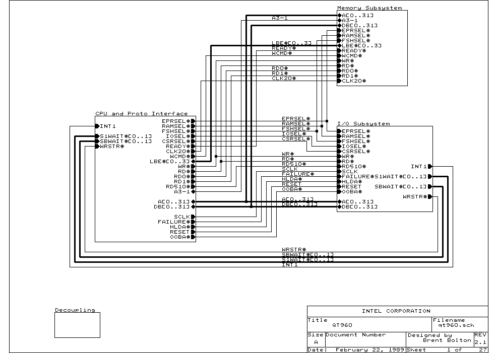

EDIT: This is what the first page of the now attached RAS file looks like if anyone's curious.
