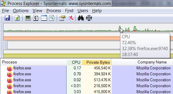

Usually it runs lukewarm but sometimes it gets quite warm for no discernible reason; could that maybe be Norton running in the background?
you can check the Task Manager or get something like Process Explorer (I use the portable version).
See screenshot, it will show the biggest user in tooltip, but while the CPU or memory is actually being hogged, you can sort by either of those columns and see which are the biggest users
