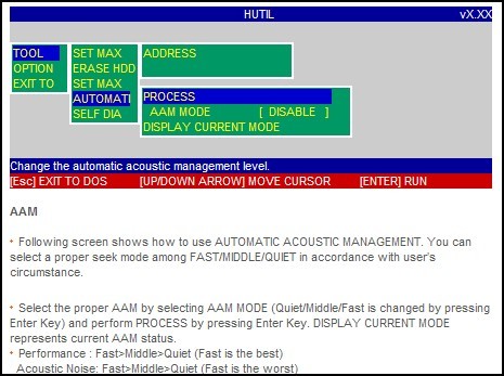

hard drive noise drives me insane. i went crazy a few months ago and bought all the 'quiet' kit i could afford. so, two samsung spinpoints (meant to be super quiet) and two raptor drives (quiet spinning but super loud clicking).
I read about it recently. There's a tool from Samsung to change the acoustic noise level of Spinpoint drives.
http://www.samsung.com/Products/HardDiskDrive/utilities/hutil.htm

« Reply #13 on: September 30, 2006, 08:33 PM »
Note that AAM slows down hard drive performance noticeably however. It's the price you pay for quiet I guess.
