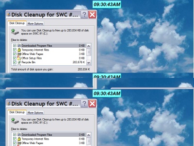

Using 1.01.19 and have downloaded it twice. I get three images when I select any option. Please see picture. The date in the picture is at the top of my screen.
p.s.-how do I post a picture in this spot?

SWC45
  • Posts: 6
Re: Three images are captured with one click
« Reply #2 on: July 05, 2005, 03:06 PM »
Here is the picture. Remember, the date is at the top of my screen. The date is the small blue box with black type.

SWC45
  • Posts: 6
« Reply #3 on: July 05, 2005, 03:10 PM »
Please substitute the word time for date. Sorry.
« Reply #5 on: July 05, 2005, 03:32 PM »
that is really a bizarre problem;
do you have multiple monitors? what operating system are you using?
do you get those 3 image things even if you select a specific rectangular region, rather than the whole desktop?
anyone else experiencing this?
« Reply #6 on: July 05, 2005, 03:58 PM »
could you try changing the color depth of your desktop (ie right click desktop -> properties -> settings -> color quality)
and/or maybe desktop resolution, just to see if that has any effect? maybe it would yield a clue.

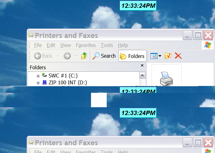

SWC45
  • Posts: 6
« Reply #7 on: July 05, 2005, 04:41 PM »
I just downloaded the members version, v1.01.20, and I still have the same problem. Here is the picture I got when I grabbed the current open window.
SWC45
  • Posts: 6
« Reply #8 on: July 05, 2005, 04:54 PM »
I just reviewed my last post and I apoligise for not resizing it down. Also I noticed that when you look at the left side of the picture you see that there are actually four (4) images.
I'm using one monitor, Dell P780, and the screen resolution is set at 800x600. I changed the resolution to 1024x768 and still have the same problem. The color quality is set at the highest of 32 bit. My only other choice is 16 bit. I'll try another test at 16 bit.
