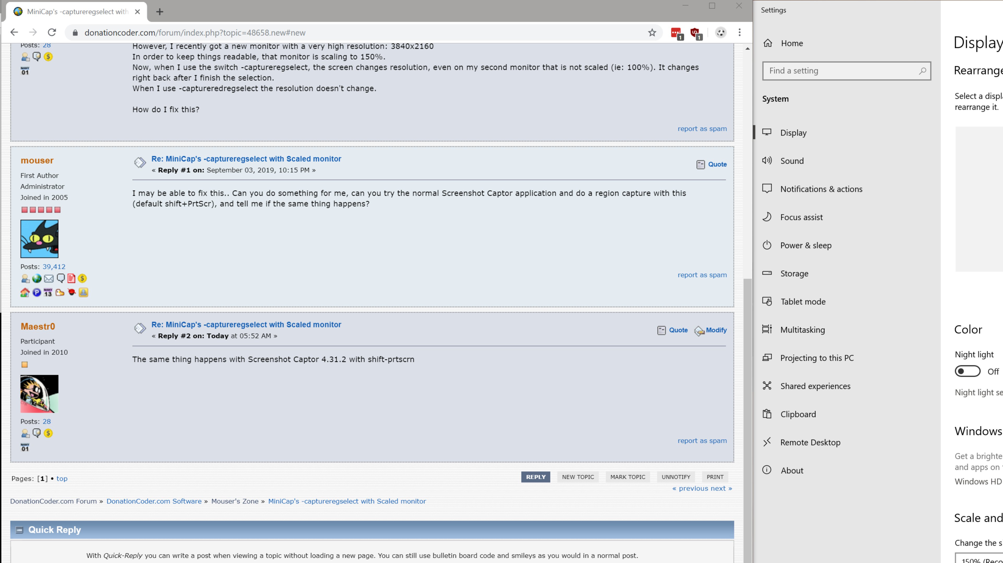

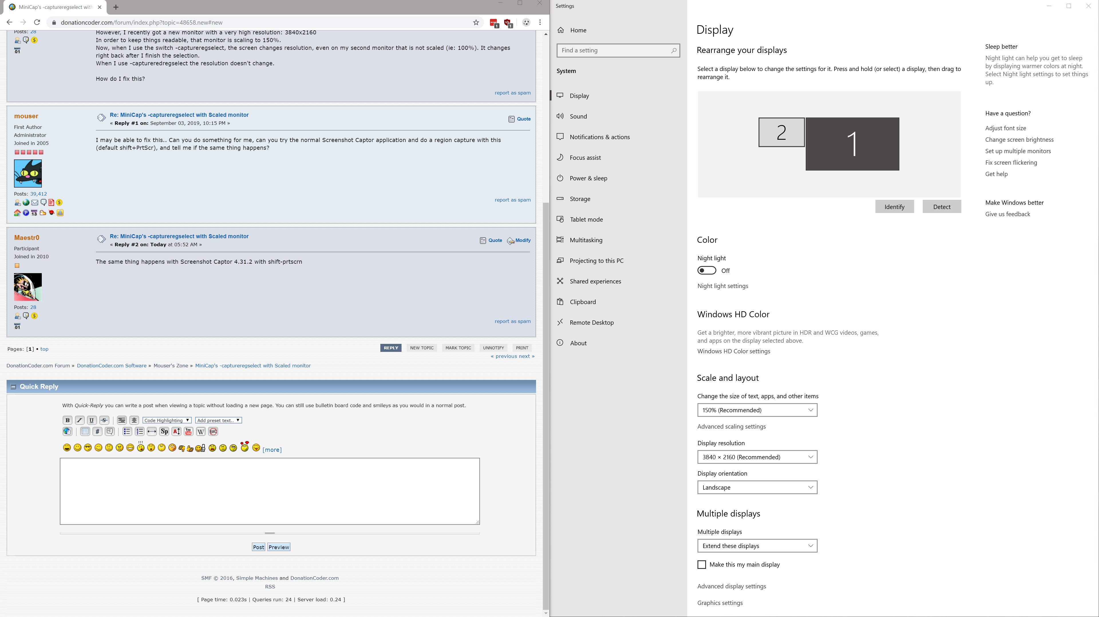

Here's two attachments.
Full Screen is just one monitor as it shows (so scaled 150%).
The second screen the same monitor is when I do the regselect using minicap and the shift-prtscr with Screenshot Captor.
(I did a printscreen and cropped out the extra monitor both times)
