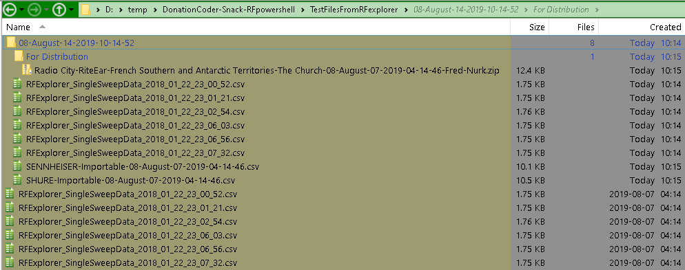

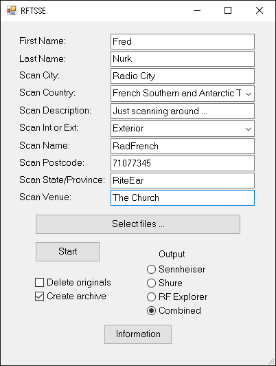

The below is functionally similar to the original PoSh script, the changes are:
  1. Put almost everything into Functions so they can be transplanted into other scripts.
  2. Added a WPF GUI (the implemented version is just something simple but more than doubles the size of the script) - it would benefit from having a ListBox that shows the selected files and a TextBox that shows the progress of the operation.  I kept it simple so as to not invest too much time into something that might be replaced with either, for example, an Avalonia based interface or some other language/GUI, (eg. Python).
  3. Added the ability to convert between RF Explorer, Sennheiser, and Shure input CSVs.  For example, select a Sennheiser file, select the Shure output option, hit Start.
  4. Options to either delete the original files and create a distribution archive.
NOTE: In my limited testing it worked fine but there are most likely bugs and there is no error checking, (the original script didn't have any either).
Tested on: Windows 10 Pro x64, PowerShell 5.1.18362.145, .NET 4.8

Function Create-Distribution {
  # Create a directory to store the zipped results for upload to Pet Erskines database
  New-Item -ItemType Directory "$destDirectory\For Distribution" | Out-Null
  $zipName = "$($destDirectory)\For Distribution\$($TextBox3.Text)-$($TextBox7.Text)-$($ComboBox1.Text)-$($TextBox8.Text)-$($lastwrittentime)-$($TextBox1.Text)-$($TextBox2.Text).zip"
  Compress-Archive -Path "$($destDirectory)\*.csv" -DestinationPath "$($zipName)"

$Form                            = New-Object system.Windows.Forms.Form
$Form.ClientSize                 = '400,500'
$Form.text                       = "RFTSSE"
$Form.TopMost                    = $false
$Label1                          = New-Object system.Windows.Forms.Label
$Label1.text                     = "First Name:"
$Label1.AutoSize                 = $true
$Label1.width                    = 25
$Label1.height                   = 10
$Label1.location                 = New-Object System.Drawing.Point(25,20)
$Label1.Font                     = 'Microsoft Sans Serif,10'
$TextBox1                        = New-Object system.Windows.Forms.TextBox
$TextBox1.multiline              = $false
$TextBox1.width                  = 210
$TextBox1.height                 = 20
$TextBox1.location               = New-Object System.Drawing.Point(160,18)
$TextBox1.Font                   = 'Microsoft Sans Serif,10'
$Label2                          = New-Object system.Windows.Forms.Label
$Label2.text                     = "Last Name:"
$Label2.AutoSize                 = $true
$Label2.width                    = 25
$Label2.height                   = 10
$Label2.location                 = New-Object System.Drawing.Point(25,46)
$Label2.Font                     = 'Microsoft Sans Serif,10'
$TextBox2                        = New-Object system.Windows.Forms.TextBox
$TextBox2.multiline              = $false
$TextBox2.width                  = 210
$TextBox2.height                 = 20
$TextBox2.location               = New-Object System.Drawing.Point(160,43)
$TextBox2.Font                   = 'Microsoft Sans Serif,10'
$Label3                          = New-Object system.Windows.Forms.Label
$Label3.text                     = "Scan City:"
$Label3.AutoSize                 = $true
$Label3.width                    = 25
$Label3.height                   = 10
$Label3.location                 = New-Object System.Drawing.Point(25,70)
$Label3.Font                     = 'Microsoft Sans Serif,10'
$TextBox3                        = New-Object system.Windows.Forms.TextBox
$TextBox3.multiline              = $false
$TextBox3.width                  = 210
$TextBox3.height                 = 20
$TextBox3.location               = New-Object System.Drawing.Point(160,68)
$TextBox3.Font                   = 'Microsoft Sans Serif,10'
$Label4                          = New-Object system.Windows.Forms.Label
$Label4.text                     = "Scan Country:"
$Label4.AutoSize                 = $true
$Label4.width                    = 25
$Label4.height                   = 10
$Label4.location                 = New-Object System.Drawing.Point(25,95)
$Label4.Font                     = 'Microsoft Sans Serif,10'
$ComboBox1                       = New-Object system.Windows.Forms.ComboBox
$ComboBox1.width                 = 210
$ComboBox1.height                = 20
@("Afghanistan","Albania","Algeria","American Samoa","Andorra","Angola","Anguilla","Antarctica","Antigua and Barbuda","Argentina","Armenia","Aruba","Australia","Austria","Azerbaijan","Bahamas","Bahrain","Bangladesh","Barbados","Belarus","Belgium","Belize","Benin","Bermuda","Bhutan","Bolivia","Bosnia and Herzegovina","Botswana","Bouvet Island","Brazil","British Antarctic Territory","British Indian Ocean Territory","British Virgin Islands","Brunei","Bulgaria","Burkina Faso","Burundi","Cambodia","Cameroon","Canada","Canton and Enderbury Islands","Cape Verde","Cayman Islands","Central African Republic","Chad","Chile","China","Christmas Island","Cocos [Keeling] Islands","Colombia","Comoros","Congo - Brazzaville","Congo - Kinshasa","Cook Islands","Costa Rica","Croatia","Cuba","Cyprus","Czech Republic","Côte d’Ivoire","Denmark","Djibouti","Dominica","Dominican Republic","Dronning Maud Land","East Germany","Ecuador","Egypt","El Salvador","Equatorial Guinea","Eritrea","Estonia","Ethiopia","Falkland Islands","Faroe Islands","Fiji","Finland","France","French Guiana","French Polynesia","French Southern Territories","French Southern and Antarctic Territories","Gabon","Gambia","Georgia","Germany","Ghana","Gibraltar","Greece","Greenland","Grenada","Guadeloupe","Guam","Guatemala","Guernsey","Guinea","Guinea-Bissau","Guyana","Haiti","Heard Island and McDonald Islands","Honduras","Hong Kong SAR China","Hungary","Iceland","India","Indonesia","Iran","Iraq","Ireland","Isle of Man","Israel","Italy","Jamaica","Japan","Jersey","Johnston Island","Jordan","Kazakhstan","Kenya","Kiribati","Kuwait","Kyrgyzstan","Laos","Latvia","Lebanon","Lesotho","Liberia","Libya","Liechtenstein","Lithuania","Luxembourg","Macau SAR China","Macedonia","Madagascar","Malawi","Malaysia","Maldives","Mali","Malta","Marshall Islands","Martinique","Mauritania","Mauritius","Mayotte","Metropolitan France","Mexico","Micronesia","Midway Islands","Moldova","Monaco","Mongolia","Montenegro","Montserrat","Morocco","Mozambique","Myanmar [Burma]","Namibia","Nauru","Nepal","Netherlands","Netherlands Antilles","Neutral Zone","New Caledonia","New Zealand","Nicaragua","Niger","Nigeria","Niue","Norfolk Island","North Korea","North Vietnam","Northern Mariana Islands","Norway","Oman","Pacific Islands Trust Territory","Pakistan","Palau","Palestinian Territories","Panama","Panama Canal Zone","Papua New Guinea","Paraguay","People's Democratic Republic of Yemen","Peru","Philippines","Pitcairn Islands","Poland","Portugal","Puerto Rico","Qatar","Romania","Russia","Rwanda","Réunion","Saint Barthélemy","Saint Helena","Saint Kitts and Nevis","Saint Lucia","Saint Martin","Saint Pierre and Miquelon","Saint Vincent and the Grenadines","Samoa","San Marino","Saudi Arabia","Senegal","Serbia","Serbia and Montenegro","Seychelles","Sierra Leone","Singapore","Slovakia","Slovenia","Solomon Islands","Somalia","South Africa","South Georgia and the South Sandwich Islands","South Korea","Spain","Sri Lanka","Sudan","Suriname","Svalbard and Jan Mayen","Swaziland","Sweden","Switzerland","Syria","São Tomé and Príncipe","Taiwan","Tajikistan","Tanzania","Thailand","Timor-Leste","Togo","Tokelau","Tonga","Trinidad and Tobago","Tunisia","Turkey","Turkmenistan","Turks and Caicos Islands","Tuvalu","U.S. Minor Outlying Islands","U.S. Miscellaneous Pacific Islands","U.S. Virgin Islands","Uganda","Ukraine","Union of Soviet Socialist Republics","United Arab Emirates","United Kingdom","United States","Unknown or Invalid Region","Uruguay","Uzbekistan","Vanuatu","Vatican City","Venezuela","Vietnam","Wake Island","Wallis and Futuna","Western Sahara","Yemen","Zambia","Zimbabwe","Åland Islands") | ForEach-Object {[void] $ComboBox1.Items.Add($_)}
$ComboBox1.location              = New-Object System.Drawing.Point(160,93)
$ComboBox1.Font                  = 'Microsoft Sans Serif,10'
$Label5                          = New-Object system.Windows.Forms.Label
$Label5.text                     = "Scan Description:"
$Label5.AutoSize                 = $true
$Label5.width                    = 25
$Label5.height                   = 10
$Label5.location                 = New-Object System.Drawing.Point(25,121)
$Label5.Font                     = 'Microsoft Sans Serif,10'
$TextBox4                        = New-Object system.Windows.Forms.TextBox
$TextBox4.multiline              = $false
$TextBox4.width                  = 210
$TextBox4.height                 = 20
$TextBox4.location               = New-Object System.Drawing.Point(160,119)
$TextBox4.Font                   = 'Microsoft Sans Serif,10'
$Label6                          = New-Object system.Windows.Forms.Label
$Label6.text                     = "Scan Int or Ext:"
$Label6.AutoSize                 = $true
$Label6.width                    = 25
$Label6.height                   = 10
$Label6.location                 = New-Object System.Drawing.Point(25,146)
$Label6.Font                     = 'Microsoft Sans Serif,10'
$ComboBox2                       = New-Object system.Windows.Forms.ComboBox
$ComboBox2.width                 = 210
$ComboBox2.height                = 20
@('Interior','Exterior') | ForEach-Object {[void] $ComboBox2.Items.Add($_)}
$ComboBox2.location              = New-Object System.Drawing.Point(160,144)
$ComboBox2.Font                  = 'Microsoft Sans Serif,10'
$Label7                          = New-Object system.Windows.Forms.Label
$Label7.text                     = "Scan Name:"
$Label7.AutoSize                 = $true
$Label7.width                    = 25
$Label7.height                   = 10
$Label7.location                 = New-Object System.Drawing.Point(25,172)
$Label7.Font                     = 'Microsoft Sans Serif,10'
$TextBox5                        = New-Object system.Windows.Forms.TextBox
$TextBox5.multiline              = $false
$TextBox5.width                  = 210
$TextBox5.height                 = 20
$TextBox5.location               = New-Object System.Drawing.Point(160,170)
$TextBox5.Font                   = 'Microsoft Sans Serif,10'
$Label8                          = New-Object system.Windows.Forms.Label
$Label8.text                     = "Scan Postcode:"
$Label8.AutoSize                 = $true
$Label8.width                    = 25
$Label8.height                   = 10
$Label8.location                 = New-Object System.Drawing.Point(25,197)
$Label8.Font                     = 'Microsoft Sans Serif,10'
$TextBox6                        = New-Object system.Windows.Forms.TextBox
$TextBox6.multiline              = $false
$TextBox6.width                  = 210
$TextBox6.height                 = 20
$TextBox6.location               = New-Object System.Drawing.Point(160,195)
$TextBox6.Font                   = 'Microsoft Sans Serif,10'
$Label9                          = New-Object system.Windows.Forms.Label
$Label9.text                     = "Scan State/Province:"
$Label9.AutoSize                 = $true
$Label9.width                    = 25
$Label9.height                   = 10
$Label9.location                 = New-Object System.Drawing.Point(25,222)
$Label9.Font                     = 'Microsoft Sans Serif,10'
$TextBox7                        = New-Object system.Windows.Forms.TextBox
$TextBox7.multiline              = $false
$TextBox7.width                  = 210
$TextBox7.height                 = 20
$TextBox7.location               = New-Object System.Drawing.Point(160,220)
$TextBox7.Font                   = 'Microsoft Sans Serif,10'
$Label10                         = New-Object system.Windows.Forms.Label
$Label10.text                    = "Scan Venue:"
$Label10.AutoSize                = $true
$Label10.width                   = 25
$Label10.height                  = 10
$Label10.location                = New-Object System.Drawing.Point(25,247)
$Label10.Font                    = 'Microsoft Sans Serif,10'
$TextBox8                        = New-Object system.Windows.Forms.TextBox
$TextBox8.multiline              = $false
$TextBox8.width                  = 210
$TextBox8.height                 = 20
$TextBox8.location               = New-Object System.Drawing.Point(160,245)
$TextBox8.Font                   = 'Microsoft Sans Serif,10'
$Button1                         = New-Object system.Windows.Forms.Button
$Button1.text                    = "Select files ..."
$Button1.width                   = 300
$Button1.height                  = 30
$Button1.location                = New-Object System.Drawing.Point(50,280)
$Button1.Font                    = 'Microsoft Sans Serif,10'
$Button2                         = New-Object system.Windows.Forms.Button
$Button2.text                    = "Start"
$Button2.width                   = 95
$Button2.height                  = 30
$Button2.location                = New-Object System.Drawing.Point(50,320)
$Button2.Font                    = 'Microsoft Sans Serif,10'
$Label11                         = New-Object system.Windows.Forms.Label
$Label11.text                    = "Output"
$Label11.AutoSize                = $true
$Label11.width                   = 25
$Label11.height                  = 10
$Label11.location                = New-Object System.Drawing.Point(228,330)
$Label11.Font                    = 'Microsoft Sans Serif,10'
$RadioButton1                    = New-Object system.Windows.Forms.RadioButton
$RadioButton1.text               = "Sennheiser"
$RadioButton1.AutoSize           = $true
$RadioButton1.width              = 104
$RadioButton1.height             = 20
$RadioButton1.location           = New-Object System.Drawing.Point(213,350)
$RadioButton1.Font               = 'Microsoft Sans Serif,10'
$RadioButton2                    = New-Object system.Windows.Forms.RadioButton
$RadioButton2.text               = "Shure"
$RadioButton2.AutoSize           = $true
$RadioButton2.width              = 104
$RadioButton2.height             = 20
$RadioButton2.location           = New-Object System.Drawing.Point(213,370)
$RadioButton2.Font               = 'Microsoft Sans Serif,10'
$RadioButton3                    = New-Object system.Windows.Forms.RadioButton
$RadioButton3.text               = "RF Explorer"
$RadioButton3.AutoSize           = $true
$RadioButton3.width              = 104
$RadioButton3.height             = 20
$RadioButton3.location           = New-Object System.Drawing.Point(213,390)
$RadioButton3.Font               = 'Microsoft Sans Serif,10'
$RadioButton4                    = New-Object system.Windows.Forms.RadioButton
$RadioButton4.text               = "Combined"
$RadioButton4.AutoSize           = $true
$RadioButton4.width              = 104
$RadioButton4.height             = 20
$RadioButton4.Checked            = $true
$RadioButton4.location           = New-Object System.Drawing.Point(213,410)
$RadioButton4.Font               = 'Microsoft Sans Serif,10'
$CheckBox1                       = New-Object system.Windows.Forms.CheckBox
$CheckBox1.text                  = "Delete originals"
$CheckBox1.AutoSize              = $false
$CheckBox1.width                 = 120

Four problems became apparent in PowerShell Core (Windows) for the above code:
  • Initial window size could not be set
  • The font used was not recognised
  • The FileBrowser did not work (locked up the console)
  • The Information window relies on VB routines
It ran and opened a GUI but you couldn't do anything.
I've installed PowerShell Core under Windows Subsytem for Linux (WSL) so I can have a play, (also installed on a RasPi I've got with me) - doesn't run at all under PoShCore (Linux), to be expected.

I like the single UI approach.  Have been thinking whether the ability to load / save the fields at the top might make sense.  That might also make the functionality more easily packaged as a command line script for use with other tools.
Nice work with the new features and modularization.  The latter should make it easier to study and perhaps it will also facilitate work on Powershell Core compatibility.
