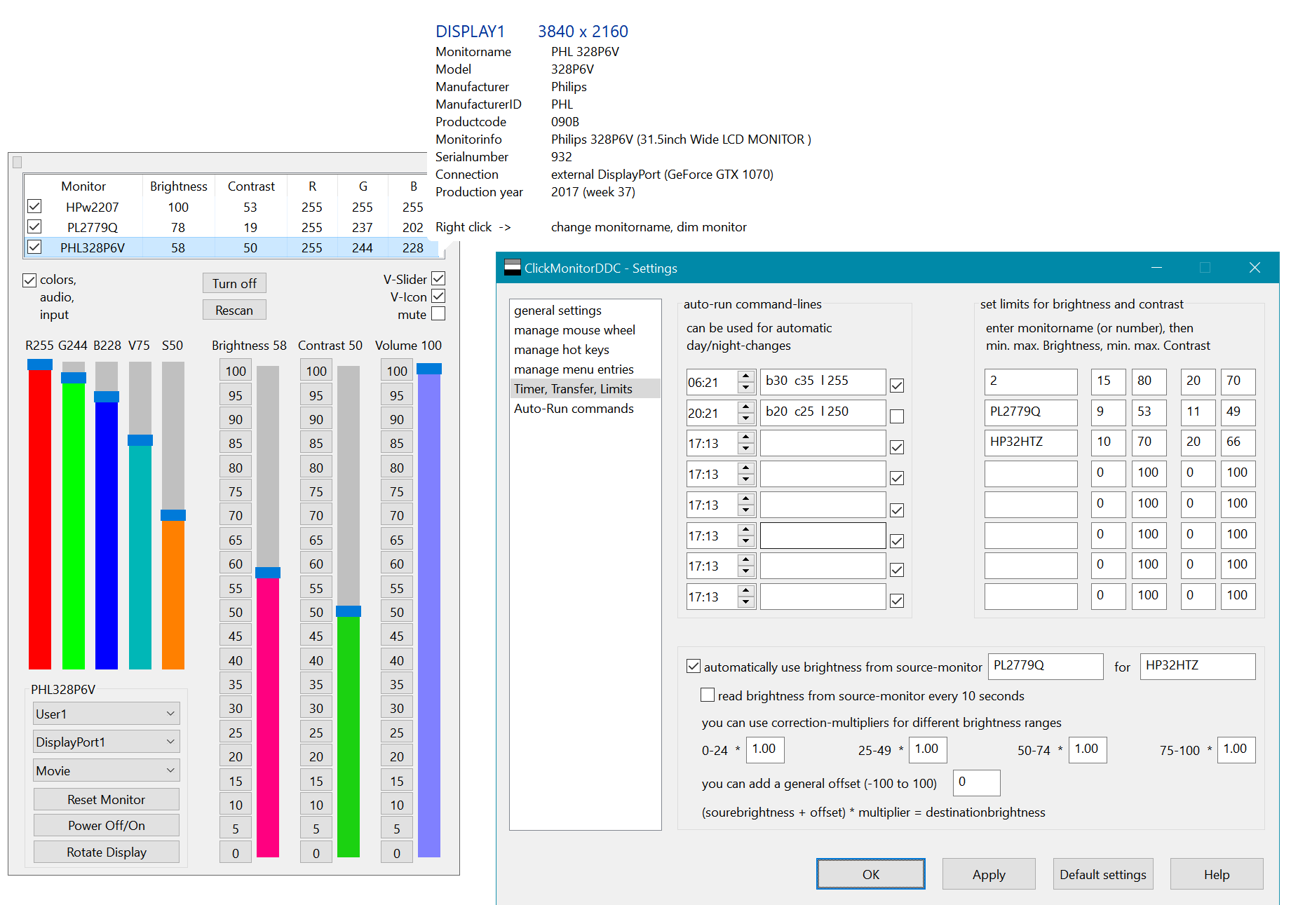

Lintalist
  • Joined in 2015
  • Posts: 122
Re: change f.lux brightness mouse remote (like Volume²)
« Reply #9 on: July 31, 2019, 08:18 PM »
Btw, does anyone know how to change the time of when F.lux switches between daytime and nighttime mode? I search on that site but no anser. Thanks!
Perhaps this program might be of interest as it has lots of manual and automatic options incl timers to change various settings. Quite a learning curve no doubt but perhaps worth the effort. Per monitor (if I'm not mistaken) and freeware and portable :)
clickmonitorddc @ https://clickmonitorddc.bplaced.net/
