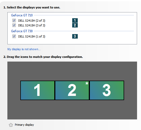

Here are my monitor display configurations.
Actually, this only happens if I try to take screenshots on the center monitor #2, where the full-size image and the crosshairs move onto monitor 3 for me to crop.  If I hit the hotkey on monitor #1 or monitor #3, it seems to work just fine.
