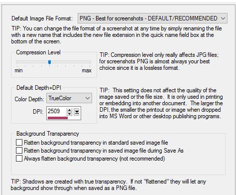

The DPI setting (as it says on that dialog in the description) does *NOT* effect quality of captured or saved images, it only effects printing.  The default values for that dialog in Screenshot captor are as follows and can be left as is:
