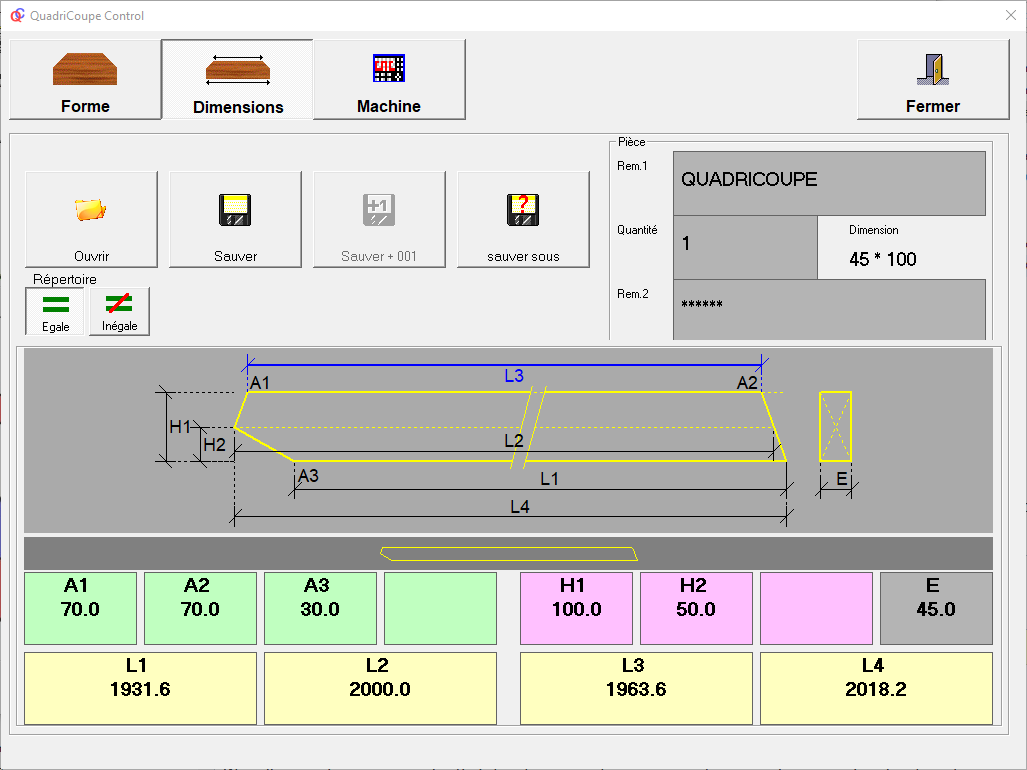

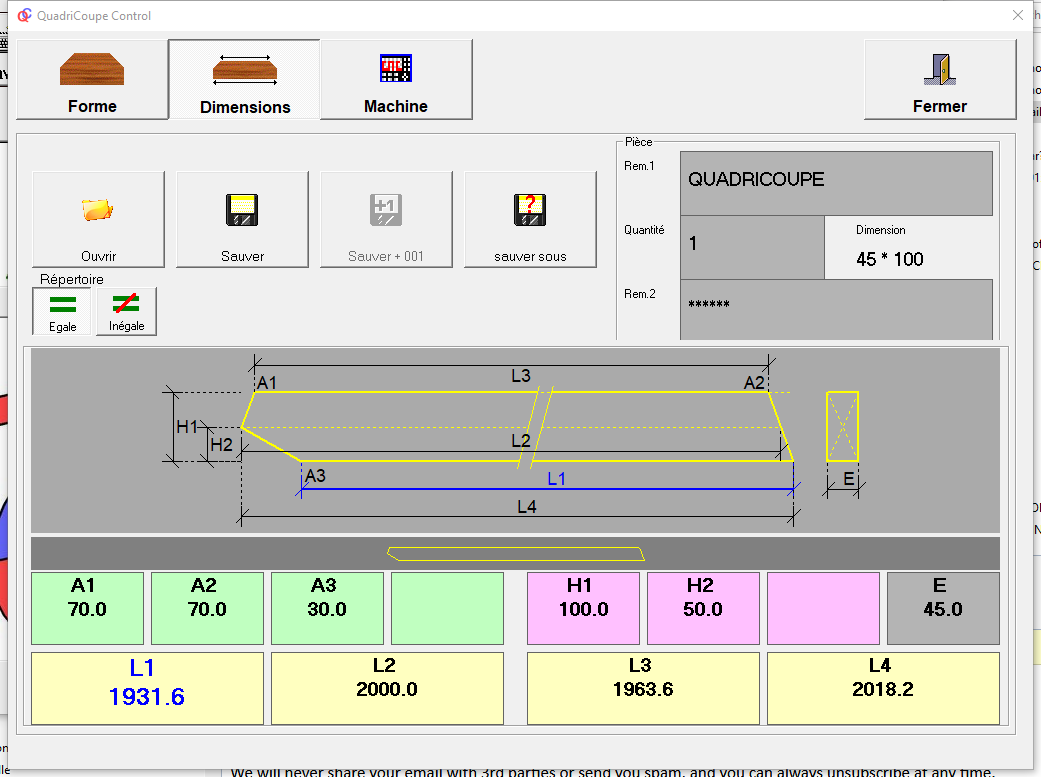

Hi,
Thanks for the reply.
Attached you'll find 2 images.
One from screenshotcaptor. The other from snipping tool.
You can see that around the screenshotcaptor image, there is a border of the underlaying screen.

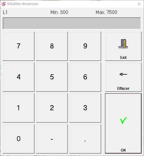

I cannot select a button or textbox with Snipping tool.
So, I installed Picpick to grab a button.
And the both button are exactly the same size. 123 x 203
Now I tested again on a form and the resulting sizes of the PNG files are different
Screenshot: 1047 x 777 ( one can clearly see the extra border)
picpick: 1027 x 770
See attached files
thx
