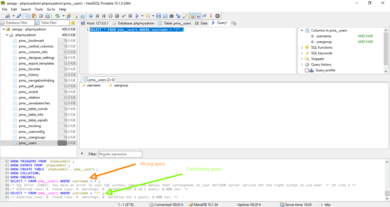

[attachthumb=#,msg428965]
Without access to your database, I just started up my XAMPP environment (which is useful for PHP script development on Windows) to connect to a MySQL database (PHPmyadmin) and show you how the query should be.

Ok. I did as you suggested. tested my query in PhpMyAdmin in my xampp. Get error:
"Error
Static analysis:
1 errors were found during analysis.
Unexpected character. (near "?" at position 50)
SQL query: Documentation
SELECT * FROM browsing_histories WHERE username = ? LIMIT 0, 25
MySQL said: Documentation
#1064 - You have an error in your SQL syntax; check the manual that corresponds to your MariaDB server version for the right syntax to use near '? LIMIT 0, 25' at line 1"
