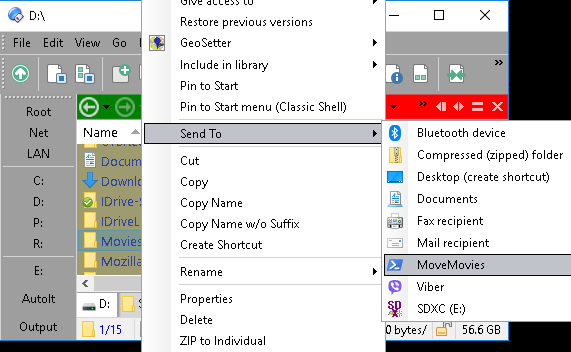

Doing it a little differently:
Put the shortcut in C:\Users\<user>\AppData\Roaming\Microsoft\Windows\SendTo, edit its Properties to point to wherever you've put the script.
Edit the path to the script:
Code: (text)
C:\Windows\System32\WindowsPowerShell\v1.0\powershell.exe -ExecutionPolicy Bypass -WindowStyle Hidden -File "C:\PoSh\MoveMovies.ps1"
  1. Right-click on the folder with the movies (MP4, MKV, FLV, AVI) -> Send To -> MoveMovies
  2. Select the destination folder
  3. Enter the gigabyte value of files to move
Hitting Cancel at any requester will exit, as will running out of space, or entering a GB value out of range.
It only checks the available space on the destination once before moving files so if you happen to copy other things to the destination that reduce the expected space then the Move-Item will fail and an error will popup, (in theory).
There's also a popup when it's finished and if you enter a number out of range.
That's about it for error checking, (hey, it's a 100% improvement over my usual error checking routines).
NOTE: Windows doesn't allow Send To on root directories so it won't work for them.  Could always add a couple of lines to call the function to ask for a Source directory instead of having it passed via Send To ... an exercise for the user.

@highend01
@4wd
@Shades
@everyone else
Guys and gals, let's wrap this one up.  Anything more we can do?
If limited to less than 2 GB to be moved, probably best to use highend01 method, one-double-click.  Easy peasy.
If more than 2 GB, 4wd has a terrific approach, just requiring a few more steps.
highend01
  • Posts: 188
Re: Batch file to move files (less than total size) from A to B
« Reply #17 on: April 10, 2019, 02:17 AM »
Sure, add the stuff from the stackoverflow link. Done.
« Reply #18 on: April 10, 2019, 03:24 AM »
By "few more steps" you mean:
1. Move shortcut from Send To to Desktop
2. Double-Click to run
Technically, that's only a couple more steps and only applies the first time.
There were simple changes you could have easily made yourself.
Learn?
