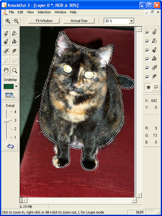

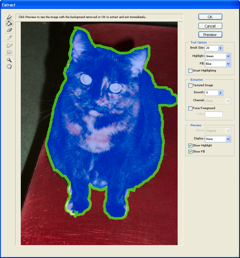

As well as the magic wand tool PS also has an 'extract' tool - which is designed to make this relatively simple. The results really depend on how complex the join is between the foreground and background and how much time you are prepared to spend fine tuning your selection. Basically you mask the edge of the bit you want to cut out and then fill the remaining area to keep with the fill tool, hit extract and it does the rest. It works best where there is a big contrast between the areas.
It is in the Filters menu ... here is the dialogue:
as a comparison here is Corel Knockout 2:
Knockout has a lot more flexibility and is quicker to use, but neither method can be described as quick methods.
