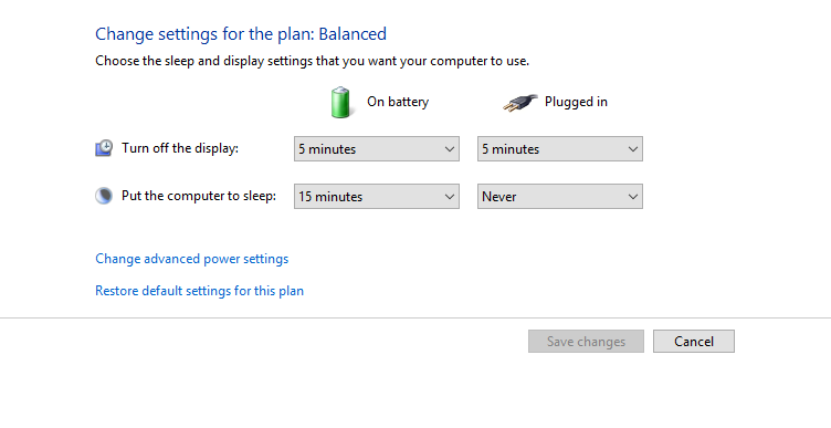

Good question, I should have been more specific: In Power Management, you are given a power option for when you would like your screen turned off at what I assume is the hardware level:
Once my afk has been detected for 5 minutes, I expect my screen to soft-power-down, meaning the lcd pixels and backlighting are turned off on my laptop monitor. I also do not expect the screen to resume until such input behavior is received from only my mouse or keyboard. My linux distros follow these rules similarly without power restoring to my monitor unexpectedly.
[attachment 1 not found]
Much better - so just the normal Windows Display off function and not "powered down".
BTW, "reactivate" the screen = turn the backlight on (with no signal, eg. no Desktop) or completely wake the screen, ie. normal backlight/Desktop ?
Asking because my computer has two monitors connected, when Windows turns the display off one monitor will go into standby, the other monitor display will go black but the backlight is still on.

eg. Until I recently decided to uninstall ~20 programs I no longer use, my computer would not go into Sleep mode, something I had become used to.
Now it does again.
It did this the night of the fresh Win10 install on a new hard drive about a month ago. So it survived an entire Hard Drive and OS clean install. Again, left overnight, no forms of Linux seem affected.
Another experiment, instead of just getting it to turn the display off, have it also Lock the computer.
This will require physical interaction with the mouse or keyboard to have the display turn on.
It's worth a shot, but I highly doubt this will affect it in any manner.
EDIT: I can't seem to find a "require login on wake" setting, but I do find a "allow wake timers" which might not have been modified on my old machine and was set to "important only", and I have now set it to "disabled". I have also set the "Screen Saver" to "none" and require login after the same amount of time as the power management to turn off my monitor.
However: None of this can explain what turns my monitor back off after turning it on.
