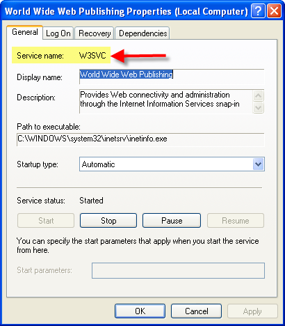

To get the service name go the Administrator Tools > Services applet and double click the service you are interested. The short name for the service is given at the top:

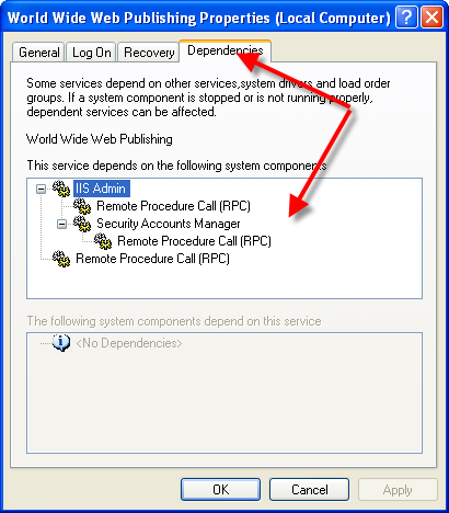

Check out the Dependencies tab:
and then open the properites for the dependency services and note their short names.

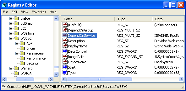

Now go to REGEDIT (take extreme care - bad registry editing can destroy your installation!) and find:
HKEY_LOCAL_MACHINE\SYSTEM\CurrentControlSet\Services\...
replacing ... witht he short service name for the service you are checking ... in my case this was:
HKEY_LOCAL_MACHINE\SYSTEM\CurrentControlSet\Services\W3SVC

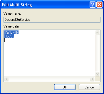

One of the values should be called "DependOnService" and should have type REG_MULTI_SZ (if there are dependencies and this value does not exist create it).
Double click "DependOnService" the dependiency servces should be listed one per line (in my case RpcSs was not listed). If any are not present you can add them here. Click OK and close REGEDIT - restart and the dependencies should be fixed.
