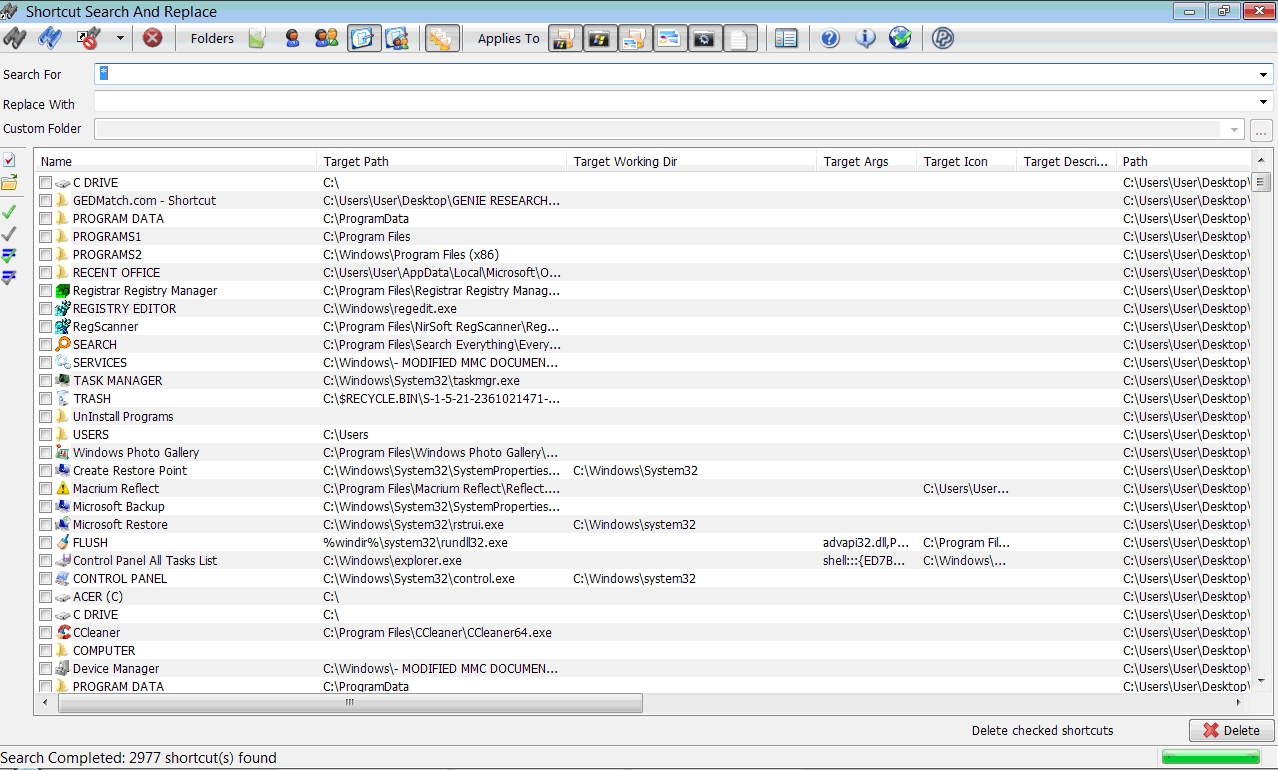

ShortcutsSearchAndReplace 1.6.11
Website: http://jacquelin.potier.free.fr/shortcutssearchandreplace/index.php
Does not work on URLs
Can search, list, and select
Not an intuitive UI

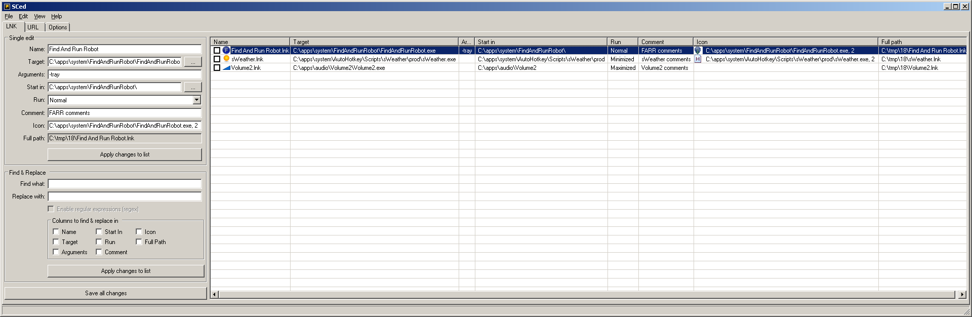

Attached is a screenshot of the ShortcutsSearchAndReplace 1.6.11 software that shows what I would like to see.  The attachment is both a jpg file and a pdf file – whatever your preference.  With the ShortcutsSearchAndReplace software, you can find, sort, and select lnk (shortcut) files.  You can also sort the columns that are listed.  However, you can NOT edit mutiple lnk (shortcut) files and you can NOT find, sort, and select url files.
If my use of the word “batch” is misleading, forget that I used it.  To restate, hopefully so that everyone can understand, I would like to find, sort, and select lnk files and url files and be able to easily edit the fields that I listed above.
Any more questions?

    • Superboy Coder
Re: IDEA: Batch Editor for URL and LNK Properties
« Reply #17 on: October 26, 2018, 04:30 AM »
I started working on this, so here's a teaser screenshot:
Obviously early...but it'll get there.

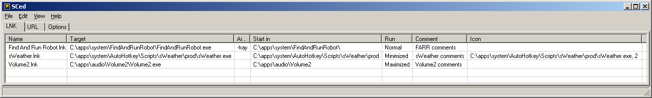

    • Superboy Coder
« Reply #20 on: November 05, 2018, 03:58 AM »
I've had some more time to work on this.  It's getting there:
I travel for work, and I've been traveling more than usual lately, so I haven't had as much time as I'd like to work on this.  Thank you for your patience.
« Last Edit: November 05, 2018, 04:05 AM by skwire »

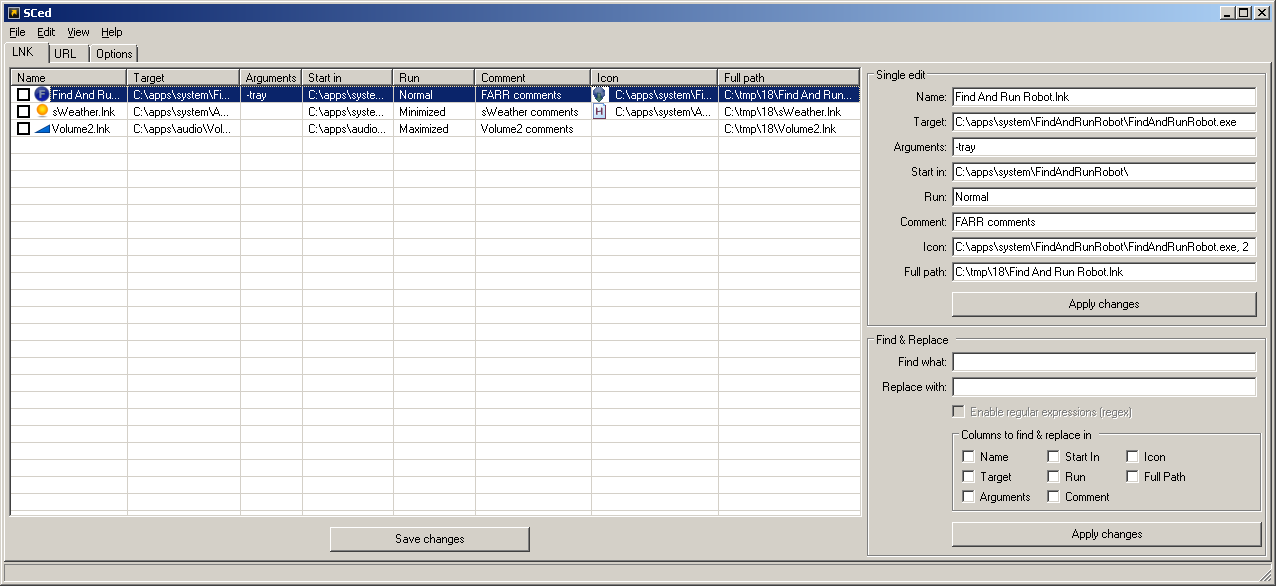

    • Superboy Coder
« Reply #21 on: November 05, 2018, 05:33 AM »
Changed up the UI a bit:
