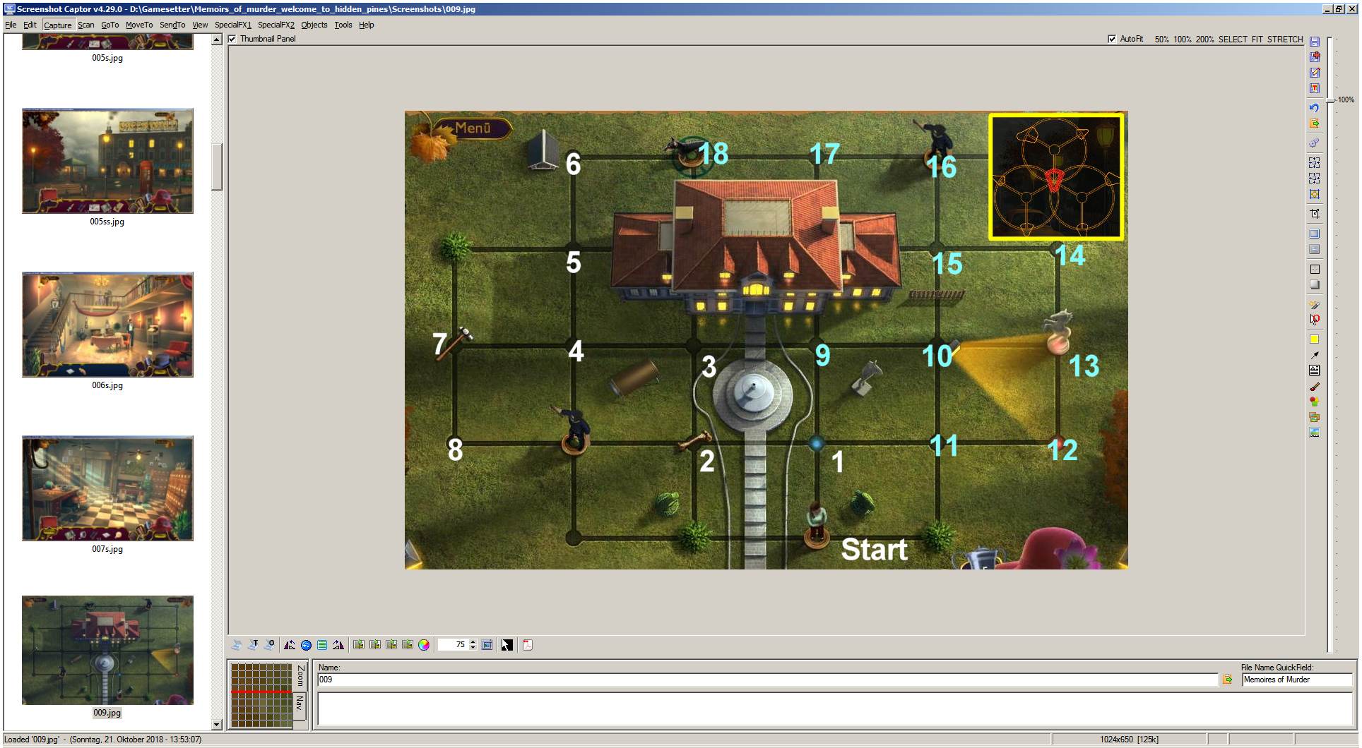

It used to be that the thumbnails showed objects included such as text, arrows, cliparts etc. This is not the case anymore which I find highly disturbing.
Now here comes the funny part: After having started a new project, the thumbnails of the former one had the objects! The new ones however did not.
Any idea anybody?

Thanks for your answers.
Restarting and rebooting is of course is what I tried in the first place, although to no avail.avail. My operating system is Win7 home premium with latest updates.
SC version is 4.29.0 which should be the newest.
There are currently about 50 screenshots in the folder, five of them with objects.
As mentioned before that very same problem occurred in my previous project. After switching to that project the thumbnails showed the objects as usual. But the new project does not. I even tried to switch back and forth but with the same results.
I guess Mouser's idea to blame the OS could be the key.
Just tried another computer, Win10 this time with the same version of SC. Here everything works just fine.
I will probably re-install SC to see what happens then.
Anyway, here is an example:

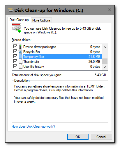

Yes, the simple explanation would seem to be that the cached thumbnails that are of concern to you - and which do not contain the latest artefacts in the original image and that were added to that image - could probably be of an earlier version of the image. One can only suppose as to why the cached thumbnail was not updated.
Those thumbnails will have been created by the Windows OS and stored in a database/cache - which is an accumulator and will contain thumbnails of since-deleted/changed image files.
It is thus generally a good housekeeping practice to periodically run cleanmgr.exe (in Admininstrator mode and set to to clean up system files). When doing this, ensure that there is a tick against the "Thumbnails" item. For example:
The example screenshot above shows 26.0MB of Thumbnails - which is not much really and is usually larger (I had already not long ago run cleanmgr.exe before taking this screenshot).
It can be educational to search the system with Everything for files with "thumb  .db" (with the embedded space). That will identify all the Thumbnail-related files that comprise the 26.0MB  - in my case, they are mostly/all in:
C:\Users\[UserID]\AppData\Local\Microsoft\Windows\Explorer\
Those files will have names with "thumbcache" in them - e.g. "thumbcache_768.db".
An Everything search will also be able to show you where all the "Thumb" and "Thumb  .db' named files are, so that you can delete them as necessary. Generally, system "Thumbs.db" files are to be found in all those directories where images are stored. They are Windows OS system files (caches), but it doesn't hurt to periodically sweep them up in a housekeeping run - e.g., using Everything to identify them prior to deletion - since they are accumulators and could contain thumbnails of since-deleted/changed image files (hence the problem discussed here), so that, over time, they could become bloated with useless garbage. The Windows OS will recreate anew the deleted thumbnail cache - with up-to-date thumbnails - as and when it is forced to open those image files again for any purpose.
