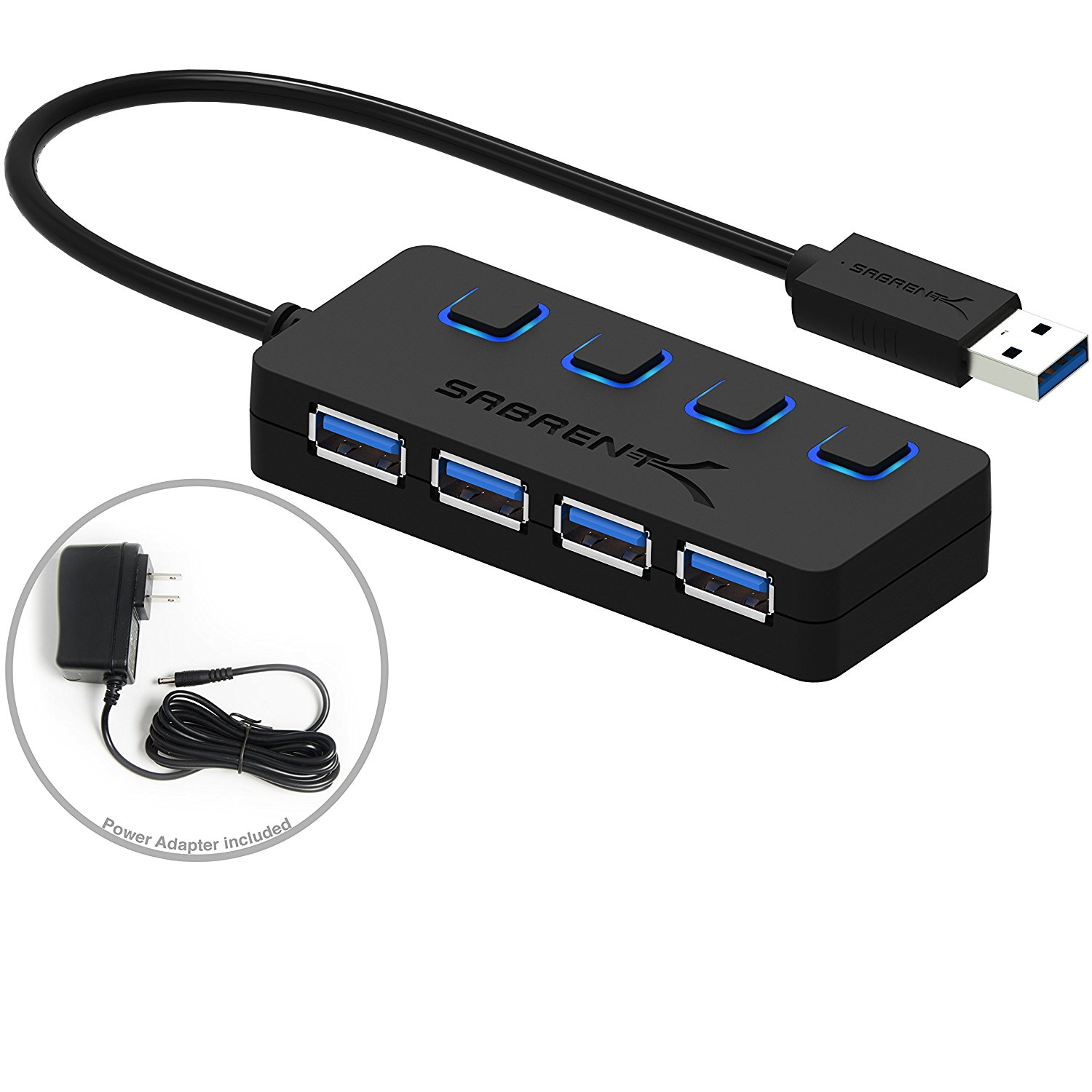

I went to order that powered USB hub and then noticed the reviews were not favorable. So, thanks (again) to the generous donation I decided to spend a little more and get this one instead. It has the added benefit of having USB 3.0 ports. :Thmbsup:
https://www.amazon.com/gp/product/B00TPMEOYM/
« Last Edit: October 01, 2018, 03:57 AM by Deozaan »
Re: Backup Power for USB device -- does it exist?
« Reply #13 on: September 28, 2018, 10:13 PM »
It works!  :Thmbsup:
Thanks for the idea, mwb1100! And thanks once again to the person who donated! :Thmbsup:
