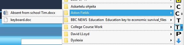

I have a query though.  I have a Directory link which allows me to drill down into folder before finally clicking on a file to open it ... except it doesn't open ...
I've got .docx files - they open.  Other files open too, although I've not tried all variations.  However, I've got loads of .doc files and they don't open.
In W10 I've set Word as the default and if I d-click on a .doc in Explorer it opens as expected.  So why doesn't LC know what to do with it ?
I've tried the Tools>Maintenance Operations and I've reinstalled LC but still it doesn't work.
The .docx in the attached clip works: the .doc doesn't.
Can anyone advise please ?

Well done Mouser !
I had that box ticked - .doc didn't work (as I mentioned earlier)
I unticked it - and it did work
I re-ticked it - .doc didn't work
I re-un-ticked it - and it does work
BUT the icon is still blank / white.  Not necessarily a problem ...
I tried exiting LC a couple of times and it changed nothing.
If you have an idea how to fix the blanks I'll be interested to hear.  It'll be easier than converting all docs to .docx !

Sorry ... I've only just noticed that the .doc's, although they were opening in Explorer ... the icon is also white there.  Very odd.
This means that LC is now doing the same as Explorer - opening .doc's but icon missing.

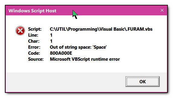

I had been having a similar problem, but it was regarding running a VBS file. The file had just one line in it. It worked repeatedly just fine, if triggered (double-click) as a .VBS file from Windows Explorer or xplorer² and if triggered via a shortcut from either of those. However, it wouldn't run at all from LBC or FARR - kept giving this error in both cases:
So, I did as you suggested above, re LBC:
...Can n you try this: Go to the topmost "Options" tab and change the setting you have for "Use file launch helper" -- see if that makes a difference?
That setting was empty (not ticked), so I ticked it, and now the script works just fine when triggered in LBC. I realise (from the Options tip in LBC) that changing that option might enable or disable effective triggering of other files via LBC (depending on other factors), so I shall see what transpires, but at least I now know how to enable the .VBS file to be triggered via LBC, so, thankyou.
EDIT: That setting in LBC seems to be not sticky, unless the user Exits LBC nicely and then restarts it.
Now all I need to figure out is how to enable the trigger via FARR ...    :o
Any ideas?
