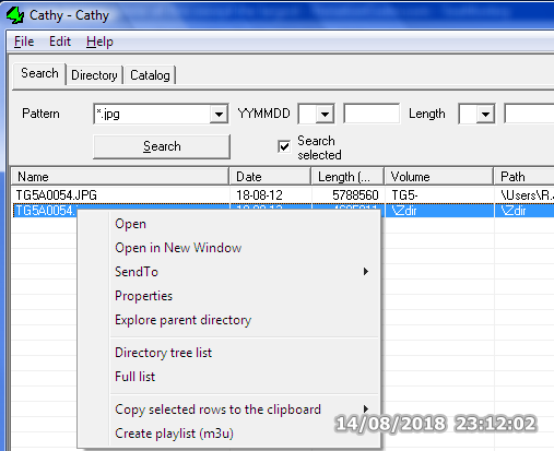

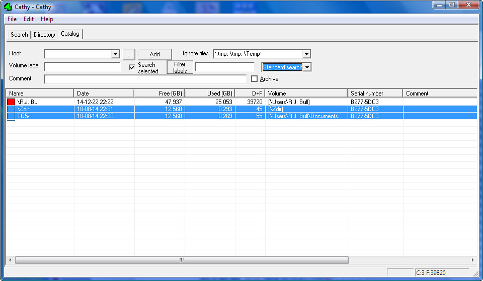

If I understand you correctly...  here's a GUI method.
Download Robert Vasicek's Cathy media cataloguing tool.  It's tiny, fast, portable and postcard-ware.  Set up the directories you want to check, make catalogues of them - no need for separate ones if they're in the same part of the tree, just include subdirectories, but mine were well separated.  Cathy can also make catalogues of CDs, DVDs, etc., i.e. offline holdings, so you can check them at the same time:

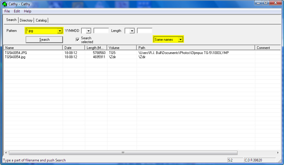

You can make one or more catalogues, highlight all the ones you want to search.  Tell it what sort of files you want to search for, in my case, *.JPG.  Then tell it you want to search not Duplicates, but Same names:
Then hit the Search button.  You can sort the resulting list by clicking the Length column:
You get a Right-Click menu, though it may not do enough for you:
There are plenty of other duplicate finder out there, e.g. the excellent Double Killer (free and payware versions): Nir Sofer's SearchMyFiles has a Duplicates mode: so does XYplorer...
