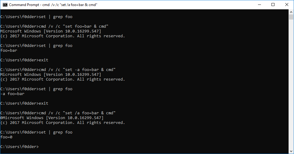

Here's a little cmd.exe session, which I hope will be instructive:
Also note that child environment is never propagated back to the parent process.

I got this "set -ua ..." off the www as a possible answer to my question.
set -u is used in Linux Bash shells.
set /a is used in Windows CLI to set environment variables using arithmetic expressions. eg. set /a "ABC+=2"
