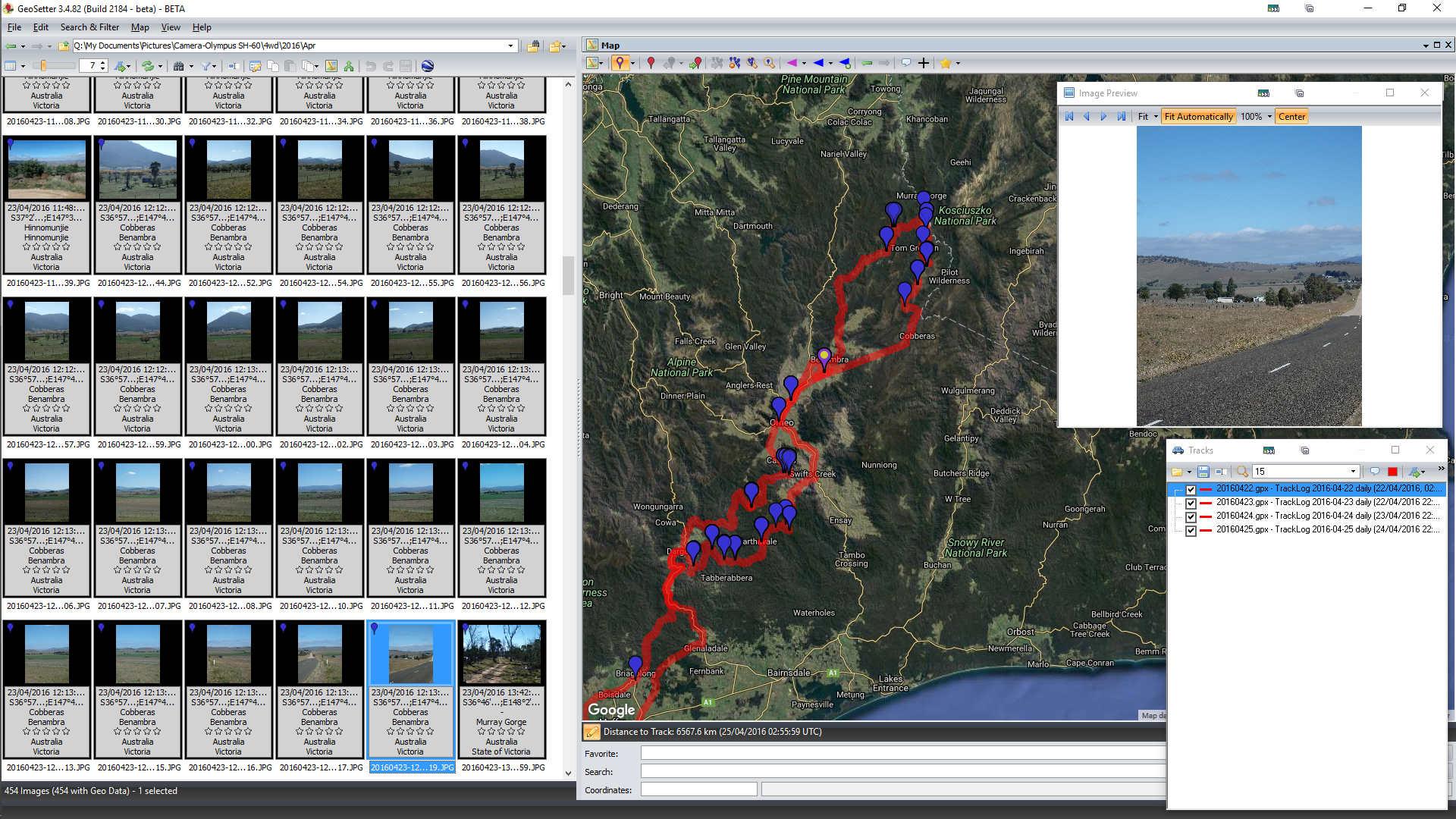

Open a GPX tracklog(s) for those images, it'll display the track on the map.

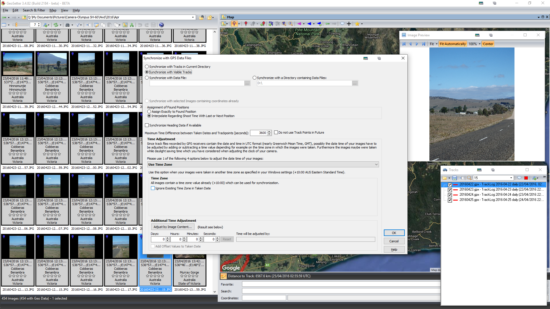

Hit Control + G to bring up the interface to synchronize the photos to the track, adjust the timezone if you need to.
If the clock on the camera is/was wrong you can add a time adjustment if required, (eg. I've corrected for the battery being flat in a camera and the clock reading 2011-01-01 00:00:00 - about 5 years out of date in one case).
Hit OK and it'll plot the photos against the track.
You can keep repeating/adjusting until you have the photos where they should be and then save them, by default it renames the original to *.jpeg_original so nothing is overwritten

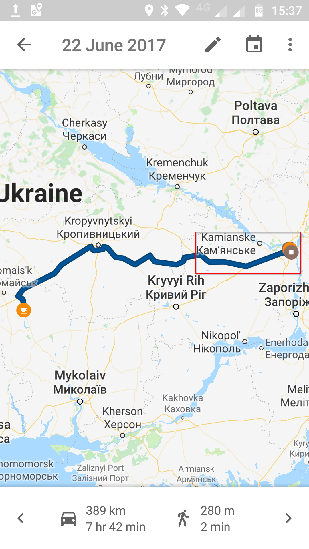

Google comes to your rescue providing you have an Android phone and have Location History turned on.
When I was in Ukraine last year I forgot to turn on the GPS Logger on the phone for the first ~200km one day which was a little annoying.
Log into Google, go to Maps and explore your Timeline:
The part in the square above was missing from my GPS tracklog.
The screenshot is from Maps on my phone, if you log in via a web browser you can do basic editing of your route along with adding points, etc.
You can then export that as a KML/KMZ track which you can convert to GPX using GPSBabel (program) or GPS Visualizer (website).
See below.

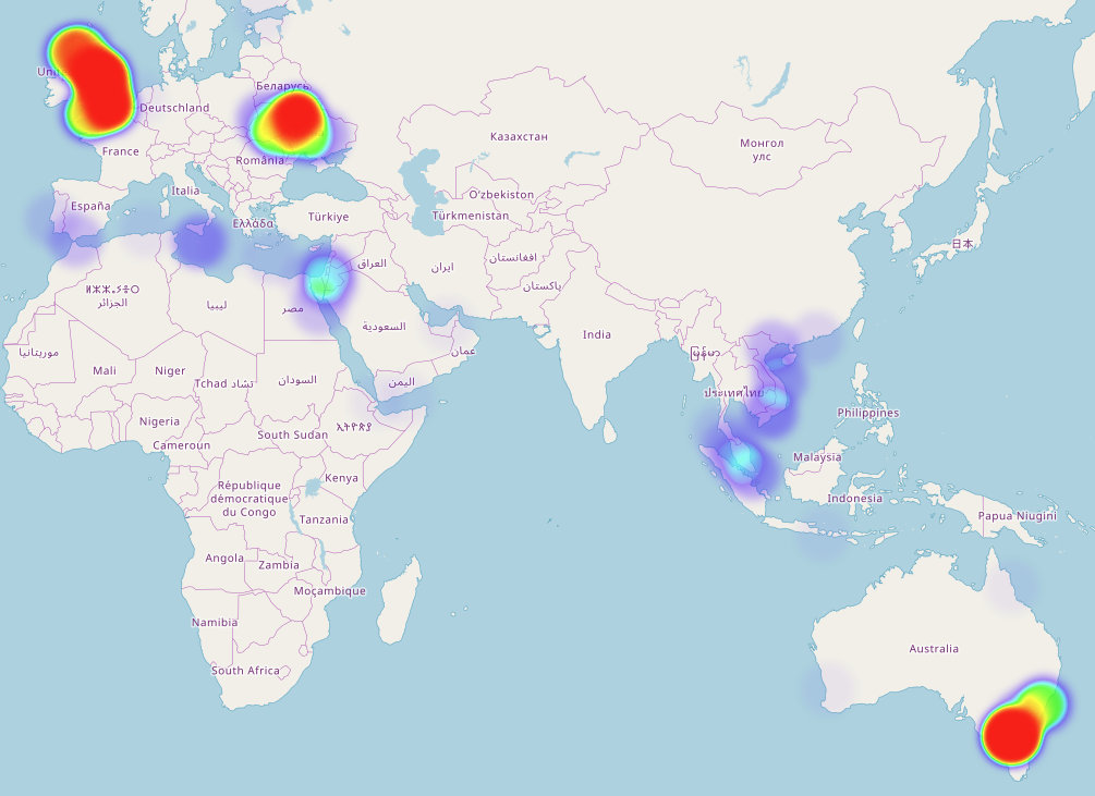

If you want to have a look where you spend your time you can upload your Location History JSON file and get a heatmap: Location History Visualizer
