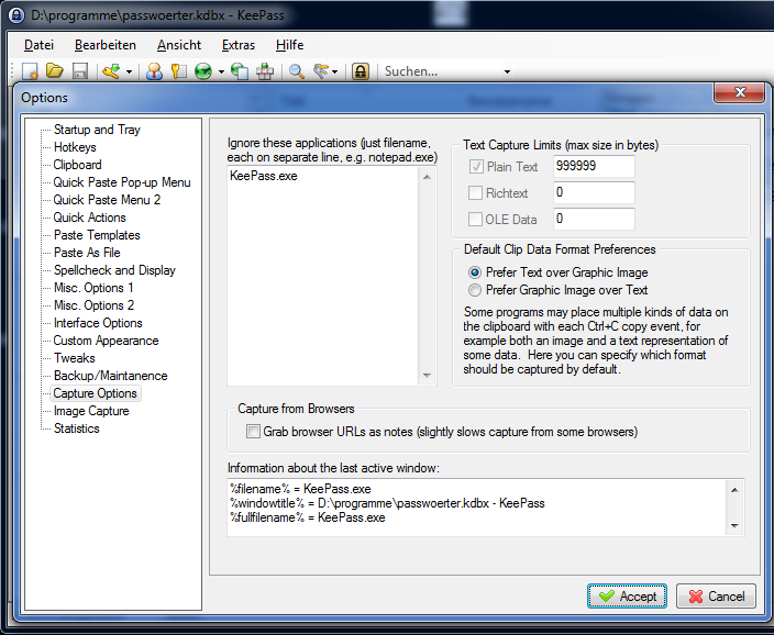

Hi,
Keepass will not be ignored even it is listed at Options | Capture Option | Ignore these…
I have copied the filename as shown in “Information about last active window:” of the same tab.
What am I doing wrong?

No problem, in the background Keepass is shown. as you can see in the below field "Information about last active window:" I have copied the EXE-Filename without changes.

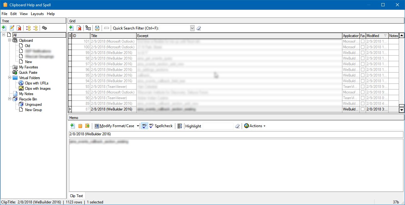

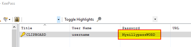

Doubleclick some entry (KeePass is set to minimize, which activates the next window, in this case Vivaldi).
CHS-window shows content of clipboard.
