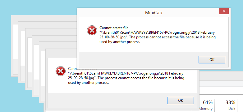

Do you have idea how to stop the error of minicap.exe?
Im trying to make a batch file that captures every 1 seconds. But when i press more that 1x per seconds?
it prompts error (see attached image). I want to disable the message error prompt.
Any ideas?
Here is my code for command prompt:
minicap.exe -capturedesktop -cursor -compress 5 -exit -save "C:\MINICAP\%COMPUTERNAME%\%USERNAME%\ $dt:%Y %B %d  %H-%M-%S$.jpg"
Thank you

Looks like it's a conflict with trying to write to the same filename simultaneously by multiple process at the same time.  Let me reproduce it and then add a few different ways to fix it.
But try this in the meantime: Add $uniquenum$ to your filename, such as:
minicap.exe -capturedesktop -cursor -compress 5 -exit -save "C:\MINICAP\%COMPUTERNAME%\%USERNAME%\ $dt:%Y %B %d  %H-%M-%S$ $uniquenum$.jpg"
I'm not sure that will solve it, because the problem may be that the file is being created by another process between the time it checks for an existing file and the time it tries to save it, but give it a try and let me know.

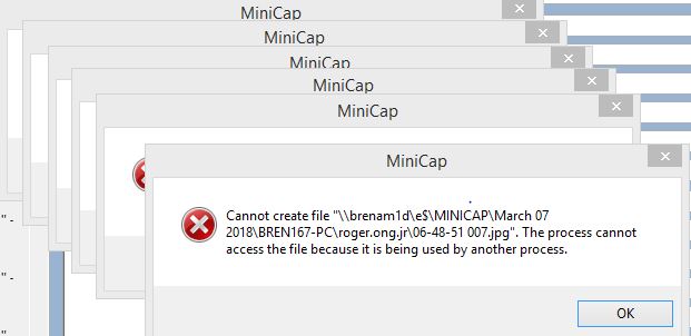

I just want to let you know. the error still occur even when i put $uniquenum$ . :(
Re: MINICAP - HOW TO DISABLED ERROR MESSAGE BOX.
« Reply #4 on: March 07, 2018, 01:43 AM »
Can you post the source for your batchfile?

But we need the file name to be exact as this  "$dt:%Y %B %d  %H-%M-%S$"  "2018 March 07  03-50-11"
It can't be EXACTLY like that because that filename is not unique if you launch this several times within one second. We could add milliseconds to the time value though, so like "2018 March 07  03-50-11-01"
Unless you are saying that if the file already exists it should just exit and not save the file.  It would be very easy to add an option for this, to simply suppress the error and not save the file if a file already exists with that name.  Is that what you'd prefer?

Unless you are saying that if the file already exists it should just exit and not save the file.  It would be very easy to add an option for this, to simply suppress the error and not save the file if a file already exists with that name.  Is that what you'd prefer?>>  Yes exactly =)  ! Please let us try and add this option to suppress that message box error. :)
« Reply #7 on: March 08, 2018, 08:08 PM »
That's easy enough.. give me a day or two.
« Reply #8 on: March 08, 2018, 09:16 PM »
Can you try this beta:
You can try passing the -noerr commandline parameter.
More importantly, the -stderr option that you tried in the past which did not work should now work properly in this case.

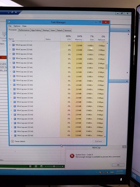

Hi Mouser,  Sorry for the very late response. I got very sick and just came back. It works perfectly  :) :) :).  But i notice a bug when i capture thousand of image and running for the long time.
Can this be fixed by Run only one instance? And also can you give me sample for the shell script that you mentioned.  Thank you.
« Reply #13 on: March 30, 2018, 10:43 PM »
Can you explain if these instances are just living for a short period -- or are you saying they are stuck and won't exit even if you stop making requests?
If the latter, then that is a bug I need to fix.  If the former, we can think about a better solution.

it stuck and won't exit even if you stop making requests but i only encounter this twice. What about automatic screenshoter?
