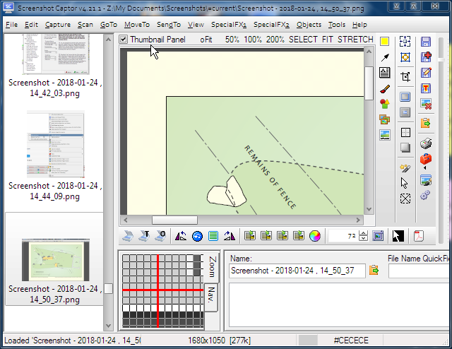

Top left corner of the viewer panel in SC, there's a little tickbox for closing the thumbnail panel. Can probably be closed via menu as well (but unsure there, currently on phone)
« Last Edit: January 30, 2018, 02:01 PM by tomos »

OK I've closed the Thumbnail Panel but it hasn't helped. Seems the only thing I can do is stop using a Google folder from with SC.
S
