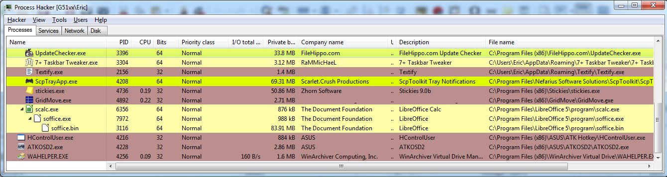

LO filenames are:
scalc.exe -> soffice.exe -> soffice.bin
and all are 64bit per Process Hacker.

soffice.exe and soffice.bin are in CHS as processes to look for to do special workarounds to avoid this bad behavior.
But scalc.exe is not.. I wonder if this could be fixed just by adding scalc.exe to my list of bad behaving clipboard apps inside CHS?
