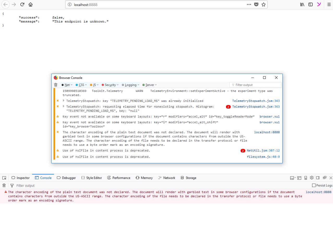

Don't think I see anything releveant but here it is (and btw that earlier 'blank' window screenshot too )

Fascinating. It seems to ignore the request parameters entirely.  :huh:

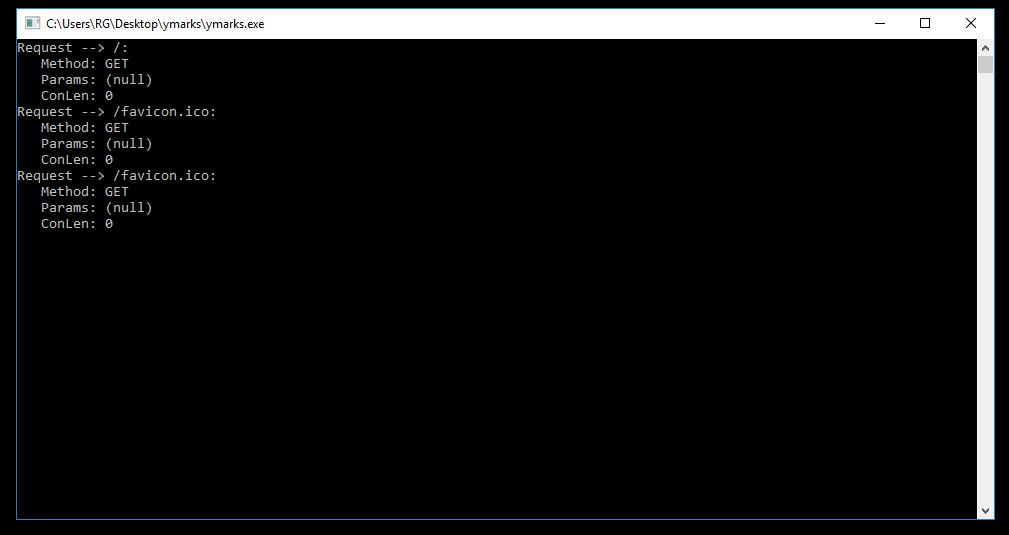

When loading http://localhost:8888/ those GET statements appear and of course the page loaded in the browser is the ""success": false ..." page

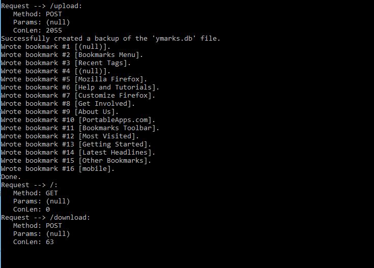

When pressing upload and then download the page in the browser doesn't change and this happens:
So I guess something is happening/working but the browser page is not exactly?

Ah, lovely.  8)
In this case: You're doing it wrong.  :-[
You were never meant to "visit" the localhost page - that's just the backend.  :Thmbsup:
I should probably add some kind of "informational HTML page" here.
The log looks as if it works. (I'll probably remove debug output some time later.)

« Reply #31 on: November 06, 2017, 10:18 PM »
I updated the .exe. No more visible server window.
You'll have to exit the server with the "quit server" button from within the extension now.  8)
I'll document that in the README in the repo.
