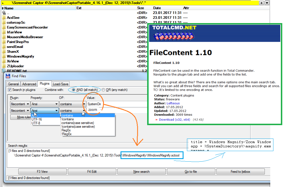

For those who utilize TotalCommander anyway, they can use a Plugin to search
for text inside of file, here "FileContent 1.10" from Lefteous:
(I have modified the screenshot to show that search works in reversed order (system/zoom)  too)
If more info is wanted, just ask,.... but I have to leave for now.
HTH?
