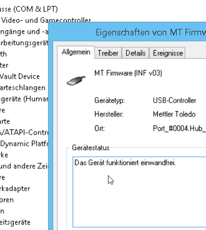

This is a shot of Device Manager > USB > context menu > Properties

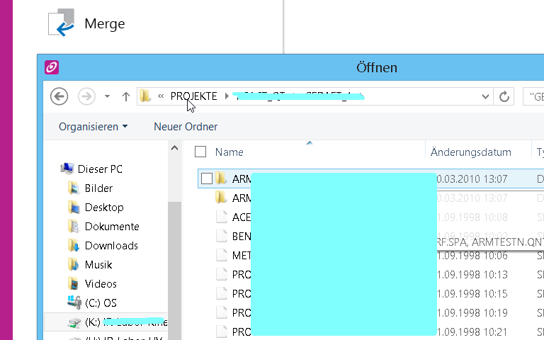

This is a full screen app > File open dialog

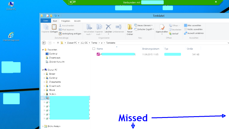

The big sized WinExplorer windows are captured with desktop background, fine, but only the top left half, not the WinEx window in whole.
It's always the same problem: only top left part is captured.
Other dialog are captured fine.

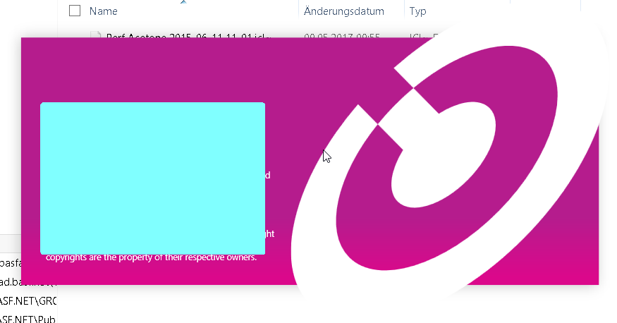

Splash pictures (on software start) are captured with some part of the background.
But that is probably intended?

Ugh! Someone reported that to me a month ago and I couldn't find the problem, but taking another look after your post I think I found it.. The manifest was not being built properly.
Please re-download and let me know if it's solved.
