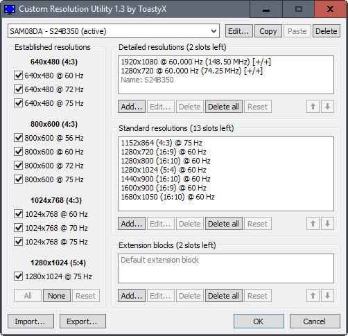

This was just on ghacks today, maybe of use:
http://www.ghacks.net/2017/04/10/custom-display-resolution-utility-for-windows/
"Custom Resolution Utility is a free portable program for Microsoft Windows devices that enables you to add custom display resolutions."

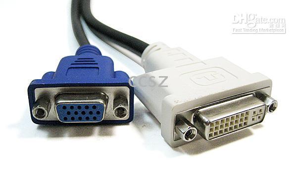

The problem is not inside the computer or inside the monitor, but outside! Yes, the problem is the cable between the pc and the monitor.
I am using the only cable I had that would fit the eh.. fitting, and it took me a long time (several days) to realize it merely is a so-called VGA cable, instead of a proper DVI cable. VGA doesn't do high definition, DVI will at least do the necessary 1920x1080.
With all relevant shops being closed for Easter, I have ordered a DVI cable to be delivered by snail-mail.
VGA (blue) and DVI (white):
- these kind of cables will only transfer video, not audio.
VGA does do 1920x1080 and will do it on your monitor according to the Packard Bell manual, which you can get here.
The monitor is not plug & play and will not provide the proper information to Windows on its own, so you need to install a driver (.INF file) that tells Windows the capabilities of the monitor.  You can download the driver from Packard Bell's GB web site here.
That said, you will get a more stable picture using the DVI cable, which transmits a digital signal (VGA is analog), but you should still install the driver to identify the monitor to Windows.

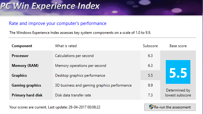

Please understand that the last week has been quite stressful to me; anything out of order is stressful ;-) My point being that I of course should have listed what measures I have tried in order to fix this weird monitor problem. To put it inaccurate but shortly: I have tried ALL the various suggestions in this thread. The .INF file from the manufacturer was last updated 2013 and was not accepted by Windows, so it didn't change a thing, and so on and on.
Only last night did I begin to understand that most of the problems were caused by the lack of activation! I tried again and again to activate the key from the laptop that I was moving from, but MS wouldn't accept it. Yesterday Windows began to say out loud so even I could understand it, that the various settings I was trying to do, wouldn't be accepted until I had activated Windows. Inside my head I expected it opposite: I wanted to be able say that this x64 Windows 10 Pro was so satisfying to me that now I wanted to also activate it! No, wrong order, MS said: Pay first, then like it - Whether you like it or not...
All this was more frustrating to me than the monitor problem. But at least I now have activated Windows.

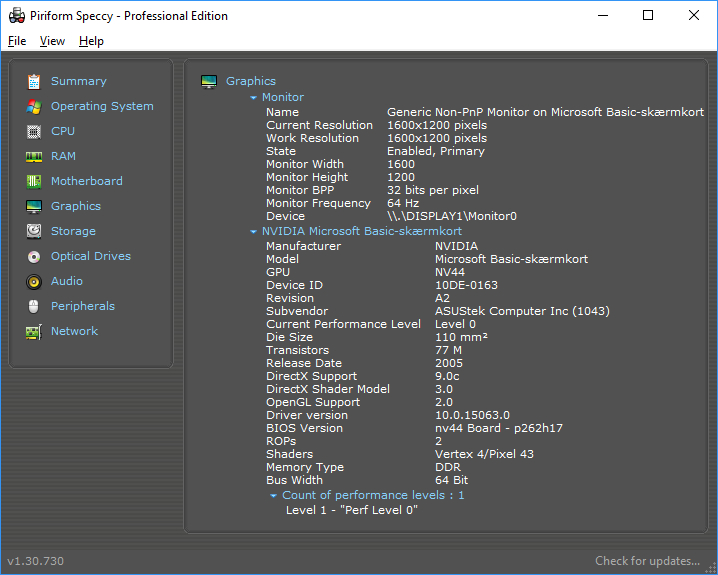

I can see that the technician has removed the old Nvidia card and replaced it with Microsoft Basic:
Modified:
quote from YouTube: "this is a video explaining why you can't update your older nvidia card - and what you can do to fix being stuck with Microsoft Basic Display Driver - and still use your windows 10 OS."
Hmm... what I think I understand is: My graphics card from Nvidia didn't comply with Win 10, so the installer (not "the technician") replaced Nvidia with MS Basic! So now I need a new graphics card? :tellme: That will take more than my two cents!

Re: will Win 10 not 'do' a 1920x1080 monitor?
« Reply #19 on: April 27, 2017, 04:56 PM »

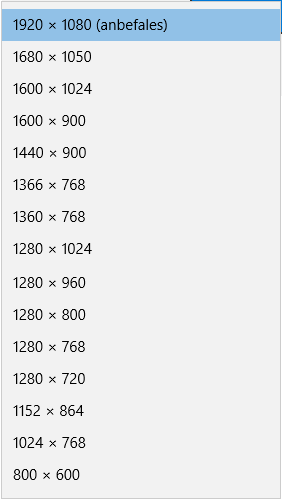

Finally I am posting from my new old computer which is connected to this 1920x1080 pixels monitor screen, and all is looking good.
Forgive me for not sounding more happy, but the technician and I misunderstood each other more than I could imagine was possible: After mounting the GeForce 710-2, as planned he also installed a Solid State Drive as my new C: drive. But then he deleted everything from my old C: hard drive, without first copying / moving / keeping anything => absolutely not according to plan! I now have a strong but empty computer.
« Last Edit: April 27, 2017, 09:53 PM by Curt »
« Reply #21 on: April 27, 2017, 09:46 PM »
thank you for the empathy, tomos.
I have more than 95% in doublet.
However, because of the chock, I didn't notice until a couple of hours ago that the operating system now is "Home", and the Microsoft robot refuses to re-accept the 'Pro' key that I activated a week ago. I have not had any chance to de-activate it, because I didn't imagine it would be necessary, and even if I had known, I don't know how to de-activate a Microsoft Windows key; I merely assume one can do it.
Modified:
Better rating, but still not great.
I realize the 9.9 is of no interest: >"We no longer run the D3D test. Returned scores and metrics are hardcoded sentinel values.">NoD3DTestRun
You can run this WEI test yourself: "Open an administrative command prompt and type winsat formal -v -xml c:\winstatresults.xml.  This will run the full formal test".
« Last Edit: April 29, 2017, 11:30 AM by Curt »
