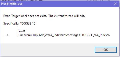

So I created an array of 47 pixel coordinates to monitor for specific color changes, there are 11 different possible colors, therefore 517 lines of monitor coding.
I'm using PixelNotifier from this site, by Skrommel. http://www.donationcoder.com/Software/Skrommel/index.html#PixelNotifier
The trouble is, it can't seem to handle more than 9/10 concurrent lines of code before erroring out.
This is the error I see, if there are more than 9 or 10 lines of code:
I would definitely like to expand this capability to be able to monitor more pixels, preferably to 517 (memory allowing) or at the very least, around 50.

The error message shows what would need to be added to make it work for the 10th menu? entry.
If you look at the script where it says
Code: ( autohotkey)
TRIGGERED_9:
triggered=9
Goto,TRIGGERED
TRIGGERED_8:
triggered=8
Goto,TRIGGERED
TRIGGERED_7:
triggered=7
; etc
what would happen (you have to try it yourself after installing AHK) if you simply add more labels
Code: ( autohotkey)
; start at 50
TRIGGERED_50:
triggered=50
Goto,TRIGGERED
; all the way to 10
TRIGGERED_12:
triggered=12
Goto,TRIGGERED
TRIGGERED_11:
triggered=11
Goto,TRIGGERED
TRIGGERED_10:
triggered=10
Goto,TRIGGERED
TRIGGERED_9:
triggered=9
Goto,TRIGGERED
TRIGGERED_8:
triggered=8
Goto,TRIGGERED
TRIGGERED_7:
triggered=7
; etc
and do the same where you find the "TOGGLE_9:" line just add TOGGLE_50 .... TOGGLE_10 above it.
