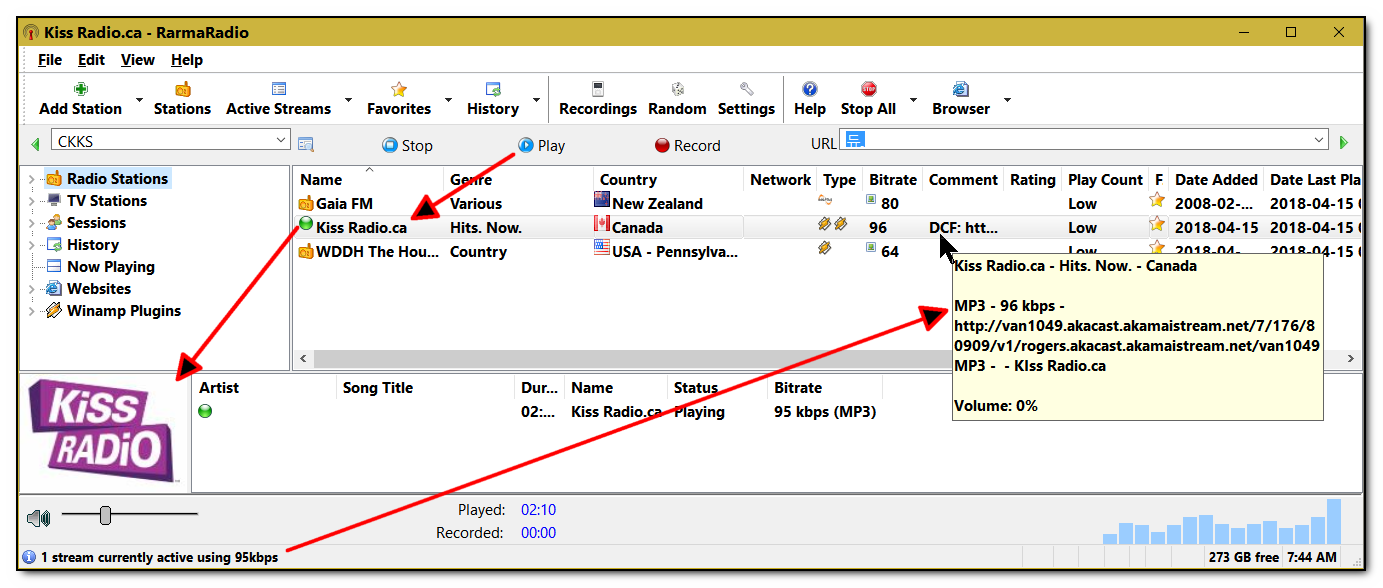

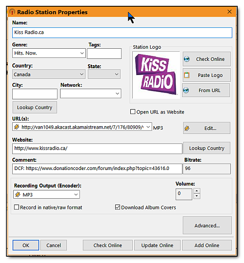

I was working on an update to the mini-review of RarmaRadio (Rarma Radio (Raimersoft) - Mini-Review) today, and started playing about with it, trying to get it to play the Kiss Radio feed.
RarmaRadio couldn't make sens of any of the links, until I inserted the one (that streams a huge MP3 file) that @thehijacker came up with:<http://van1049.akacast.akamaistream.net/7/176/80909/v1/rogers.akacast.akamaistream.net/van1049>;
I added Kiss Radio as a new radio station, giving just that URL as the feed, and copied/pasted in the logo and added a comment linking to this DCF post.
This is what the RarmaRadio Properties panel looked like after that:
I then played it in RamaRadio: (it was just streaming the MP3 file (the station does not seem to be identified in any database of Canadian radio stations). There is no data in the stream to identify the station, or the tracks/artists currently being played.
This what RarmaRadio looked like whilst the streamed file was playing:
