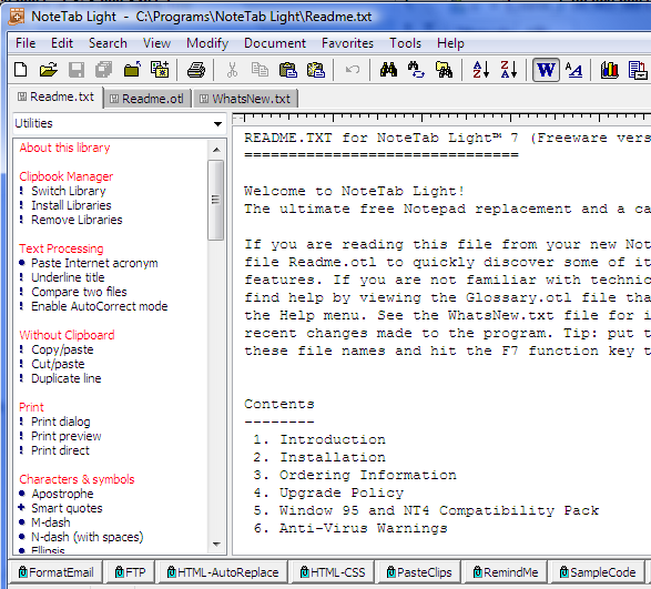

Notetab - no macro as far as I can see.
After installation, looking around for macro features, then closing and relaunching, the trial period is over
and one is sent to the Purchase website. ha!
I should have been clearer.  It doesn't have "watch my fingers, record and repeat" macros.  Instead it has a macro programming language, what they call a clipbook.  That is, you have to write code.  In the attached screenshot, the tabs along the bottom of the editing window are some of the different clipbooks Notetab Light ships with.  The narrow pane at the left is the contents of the selected clipbook.  Toggle that pane on/off with F4.
After installation, looking around for macro features, then closing and relaunching, the trial period is over and one is sent to the Purchase website. ha!
I wouldn't have expected that.  Still, save yourself some money and try out the Light version.  You can download it here.  I used it for the screenshot to show it has the clipbook system, though I'm told its engine works a bit differently than Notetab Pro.  Apart from the Help file, the best place to get help on the Notetab editors is the three Yahoo! Groups for beginners, clips, and scripts, of which clips is by far the most popular.
