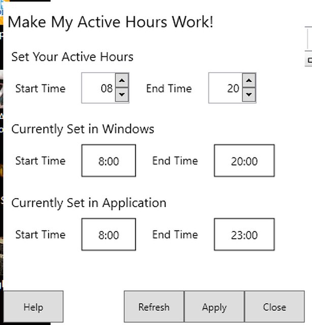

First, the interface.
Basically, if you set the active hours for longer than 12 hours, it will find a 12 hour window that works based on your current time, and set the config file to be the whole length, and the registry keys to be that 12 hours.  I was working on this very early in the morning, so when I set the span from 8AM to 11PM, it saved that to the application config (the bottom controls), and set windows to the computed span, i.e. 8AM to 8PM.

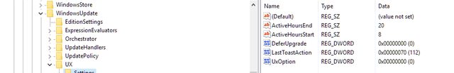

Then, the registry.
As you can see, the ActiveHoursStart key is set to 8, and the ActiveHoursEnd key is set to 20, as I expected.

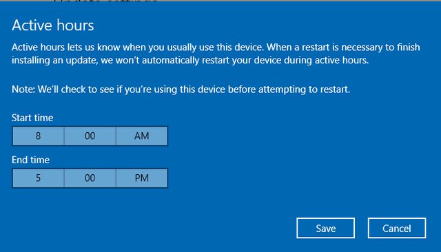

Then I open the active hours dialog.
It was set to 10AM to 10PM before this, but as you can see, it reset the dialog to 8AM to 5PM.
The registry still shows the correct thing.  But will it honor the registry?  I don't know.  I've set 3 of my computers to never reboot unless I manually reboot, so I only have one computer to test on.  I have it currently set in the registry to active hours that do not overlap the 8-5 timespan, so I guess if I'm paying attention at the time, I'll see.  But the kicker is that I have to be paying attention.
