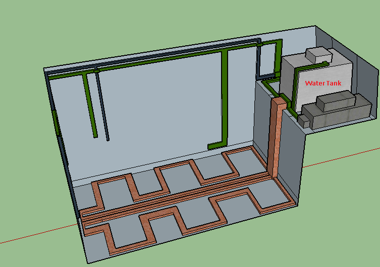

I'm now at the stage of thinking the heating system will be more than enough to warm us up even on the coldest of days - and especially with being able to control thermostats via the internet, it means that when we are out, I can set the thing to turn on when we are on the way back to the van so it's nice and warm for our return.  That coupled with the small size, I think it will be nice and cosy most of the time  :D
Below is the closed loop underfloor heating system - Underneath this will be an insulated floor, and above will be hardboard flooring which will be carpeted.  The walls will be insulated (maybe double insulated) and the windows are double glazed, so I think heat retention may now be much to worry about..I'm starting to worry it might get TOO hot too quickly and am actually looking at ways to keep that temperature at a more moderate level (I already have extractor fans and such, so that might be enough).

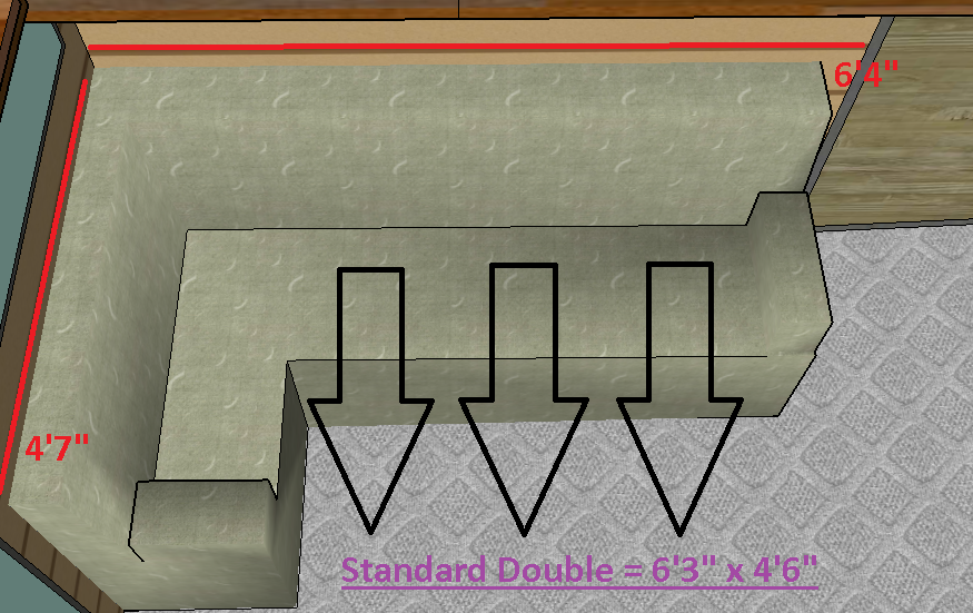

Hmm, looking at those images, I wonder where you have planned your sleeping area? Sleeping in an outside tent isn't a feasible option for 12 months, I presume.

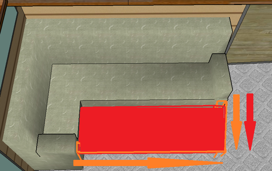

Ah yes, sorry, I should have specified that the bed is a pullout from the settee (with the bed mechanism folded and contained within the settee) - We have a memory foam mattress topper which will make the thin mattress we will inevitably have to use for that, way more comfortable. - The bed itself will be a double, so there is plenty of space to sleep.

I also had a second option to a typical folded pullout bed - which will be telescopic stands which pull out from the arms of the settee, and a base unit which will also pull out.  The missing cushioning from the bed will be stored underneath the settee also, and places on top when we go to sleep - the mattress topper will then go over both to give additional comfort.  This feels like a more irritating way of sorting out the bed at night, but far easier to repair if it breaks.
A very quick and dirty sketch done in MSPaint is below:
