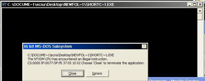

I'm having trouble running any of the exe's.  Are there any required libraries or anything?  I don't have ahk installed, I'll try that now.
The first exe says "memory allocation error, system halted."
The v1a and b ones get me this:

brett
  • Australia
  • Posts: 125
Re: DONE: Sync Network Folder Contents as Shortcuts
« Reply #11 on: July 10, 2006, 12:14 AM »
Sub Folders' yes that would work, that had me for a while. will do more tonight.
Could you give me details of your system setup.
Operating system, etc
I dont have a answer but will lokk into it.
Thanks
dB

gsull
  • Posts: 26
« Reply #12 on: July 10, 2006, 12:36 AM »
windows xp pro (sp2, all updates)
p4/3.2 (prescott, hyperthreading is turned on)
2gigs ram dual-channel 3200
can't think of anything else that would be relevant.  I'm just looking at AHK in person for the first time now.  I'll let you know if the script works on my machine.

The .ahk worked great.  I'll try compiling it and see if that works as well.  So subfolders and syncing are the only things left out of what I would suggest.
As I said, I've never used AHK before, but if there's anything I can do to help, let me know.

The .exe compiled on my machine worked.
One thing I noticed is that the "drag and drop" feature doesn't seem to do what it says, unless I misread it.  It seems to make a single shortcut to whatever is dropped onto it, and not in the destination directory, but the directory that Shortcut maker is in.

« Reply #15 on: July 10, 2006, 02:56 PM »
Hi Gsull,
if the Drag and Drop did not work on your machine, after you compiled it from your AHK, you will need to re-install AHK and when the first prompt comes to screen, make sure that 'Enable Drag and Drop' is selected in 'components to install', by default it is off.
I started to use AHK only a few months ago, so I am fairly raw, and my code might be a bit scratchy, but I am having a blast learning. (a midlife crisis)
ShortCut Maker v1c
- added sub folders. now ALL shortcuts are added to sub folders of the destination.
- reworked create code
- delete shortcuts, deletes all shortcuts from destination folder and all sub folders, be careful.
- ext choice now allows your own choice plus dropdowns
syncing tommorow, maybe, lots of real work on at the moment
envious,  8) , its not a machine problem
thanks
dB
« Last Edit: July 10, 2006, 03:02 PM by dB »

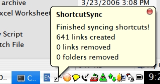

:) Here's a command line version.
ShortcutSync - Command line tool to place shortcuts to files in a different folder, preserving the tree structure, and removing missing files.
Example: ShortcutSync.exe C:\Music D:\MusicLinks mp3 wav TrayTip
Syntax: ShortcutSync.exe <fromfolder> <tofolder> <extentions> [TrayTip]
<fromfolder> is the folder where the files are located
<tofolder> is the folder where the links should be created
<extensions> is the file types to make links to
TrayTip is added for visual feedback
You'll find the downloads and more info at 1 Hour Software by Skrommel.

« Reply #18 on: July 11, 2006, 01:30 PM »
ShortcutSync
OMG, this is so unbelievable.
this small prog can really sync.
640links and with 200 folders shortcuts created in 8 seconds. :Thmbsup:
