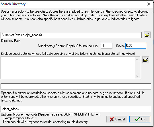

I don't share search folders because I didn't see a way to get them out of the FindAndRunRobot.ini file, which I didn't want to share across computers.
That's why i'm asking for this feature... having an extra ini file pour additionnal search folders...
I too use search folder modifiers and user variables  :Thmbsup:
I even use dynamic search folders
When switching project, the user variables change, so that the search folders change too
i can have aliases that will only search inside a particular project in many different places.
But sometimes I need to add a new search folder so that we can add a new functionality to our workflow, and in that case, I have to modify all the settings on all the computer accordingly.
