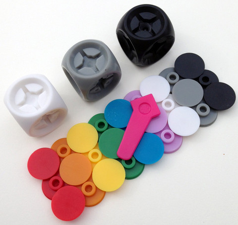

Recently a company put out some dice with colored sides that you can remove and change -- designed to be useful for prototyping games:
http://boardgamegeekstore.com/products/rattlebones-prototyping-dice
Those look interesting, but still not quite right for what I want. I want the colors & designs on each face.

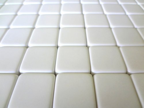

I guess I'm committed to the sticker method, as I just ordered some of these:
50 Blank White Dice 16MM

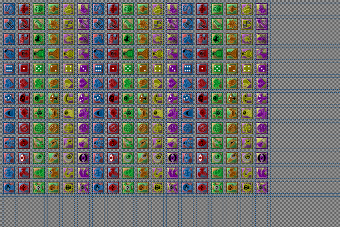

I've got the PDF all ready to go for the printer:
That's at 12.5% zoom (when you click it to view it "full-size"). I've got enough for 3 sets of 13 different dice in that image, with spare room for more. I'm really going to hate myself when I have to cut all these out and apply them one by one. :'(

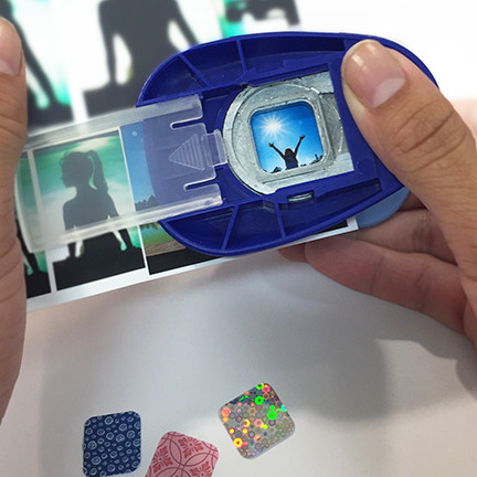

I am going to check more local crafting/hobby stores for a hole punch today, but someone pointed this one out to me online, which looks like it may just be perfect for the job since it's just slightly smaller than 16mm and has rounded corners and everything:
http://www.little-windows.com/products/small-rounded-square-5-8-punch

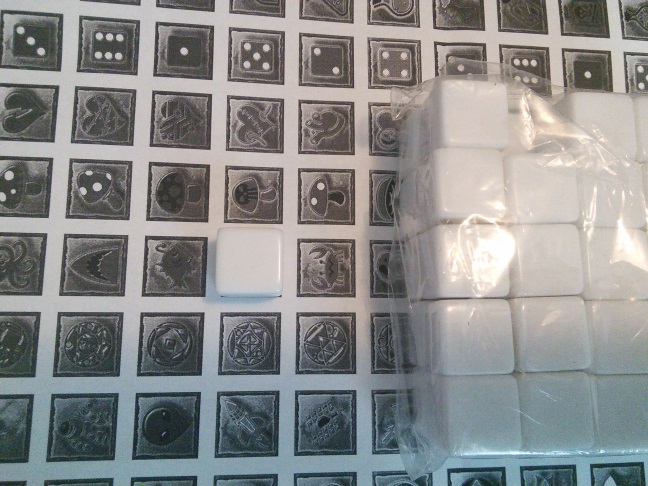

I had printed out a test sheet of paper to try to get an idea of their size, so I could find a hole punch, but all the dice I put up against it showed that my images were a bit too large by a couple mm on each side. So I was concerned I'd have to redo pretty much the entire image sheet.
But my blank dice arrived today and I guess these blank dice (16mm) are a little larger than "standard" dice (12mm?), as it seems to be a pretty close match on my test sheet of paper:
The images could be a few pixels smaller, but I think they're pretty good how they are, especially since the hole punch I ordered has rounded corners. But I'm not sure how big the hole punch will be on the paper, so I may need to make the images smaller anyway so I'm not cutting off a fairly significant portion of the borders.

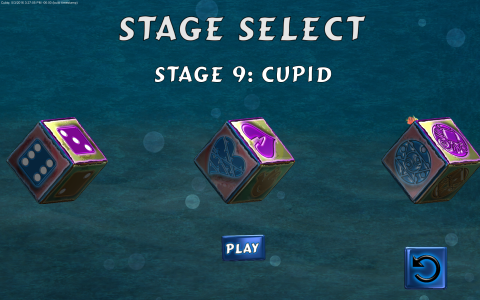

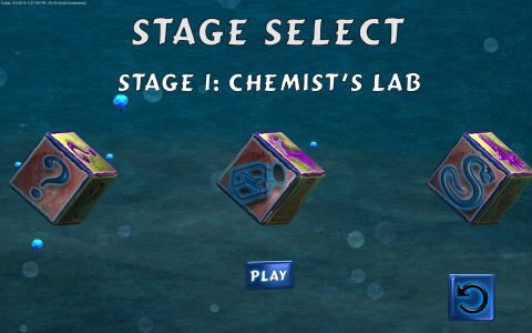

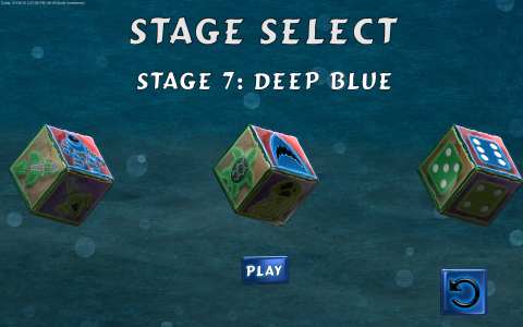

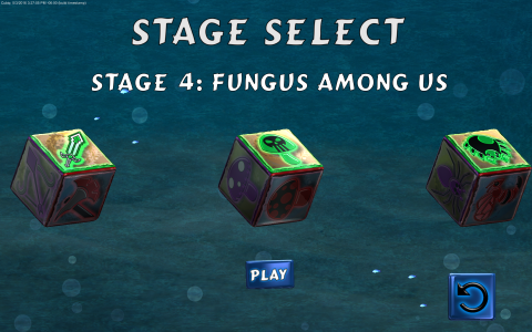

mouser pointed out to me in IRC that I never really explained what I'm going to use these custom dice for. They won't actually be used as dice, as they don't have any numbers on them (except the ones that use dice images) and their colors aren't particularly meaningful for any dice games that I know of.
The images are from a game I'm working on with a small team. The game has cubes which have these images on them. We're almost ready to release the game (at least for beta testing) and so I thought it would be fun to make real-life cubes like those in our game to give out to my team as a little celebration for launching our game.
Here are some screenshots of a development build showing off these cubes in-game:
Cubiq Stages 0-2.png Cubiq Stages 3-5.png Cubiq Stages 6-8.png Cubiq Stages 8-10.png

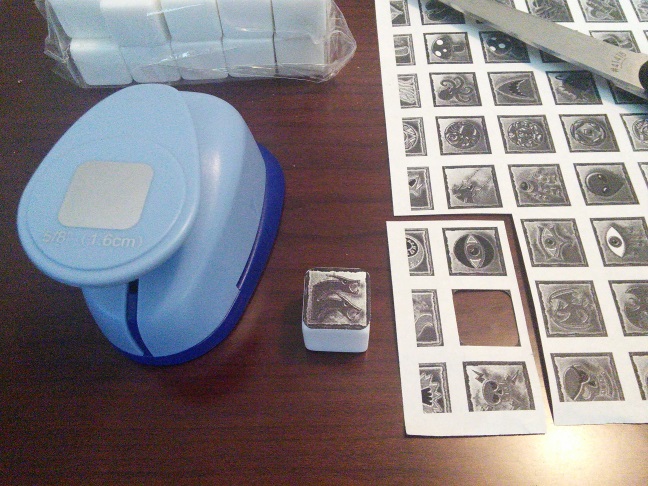

« Reply #22 on: May 06, 2016, 10:55 PM »

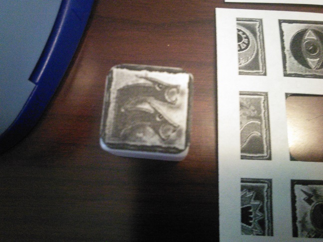

My hole punch arrived. It's labeled as being '5/8" (1.6cm)' and I believe the 16mm measurement is the accurate one, because it's just a hair too large for the dice, which are all just under 16mm3. A 15mm hole punch would probably be perfect.
It would have been nice to know before I ordered it that it was 1.6cm (the website only said it was 5/8", which is between 15mm and 16mm), but honestly I probably still would have ordered it in the hopes that it would be close enough. I just checked the listing again and it does indeed say 16mm in the description. Somehow I missed that. Oh well. That's a pity that they advertised it as 5/8" when it's actually 16mm because 5/8" is 0.625 inches which is 15.875mm which might have worked.
I'm sure you can't tell from the photos, but it's just barely large enough that it would start curling around the rounded edges of the die, which IMO means it is more likely to peel away. That said, it still might work if I make sure to coat it with Mod Podge as previously mentioned.
I'm really not sure what else to do, honestly.

Found a 1/2 square hole punch on eBay: http://www.ebay.com/itm/1-1-2-INCH-EK-SUCCESS-SQUARE-PAPER-HOLE-PUNCH-SCRAPBOOK-CARD-MAKING-/162055616560?hash=item25bb447830:g:1agAAOSwsN9W~gdk
True 15mm would be 19/32 or 15.0815mm which might still run afoul of the rounded edges. 1/2 inch is 12.7mm which might not be too bad, and is a "standard" size to can potentially be found as apposed to cu$tom made..
I'm just thinking out loud here ... Feel free to ignore me. :D
