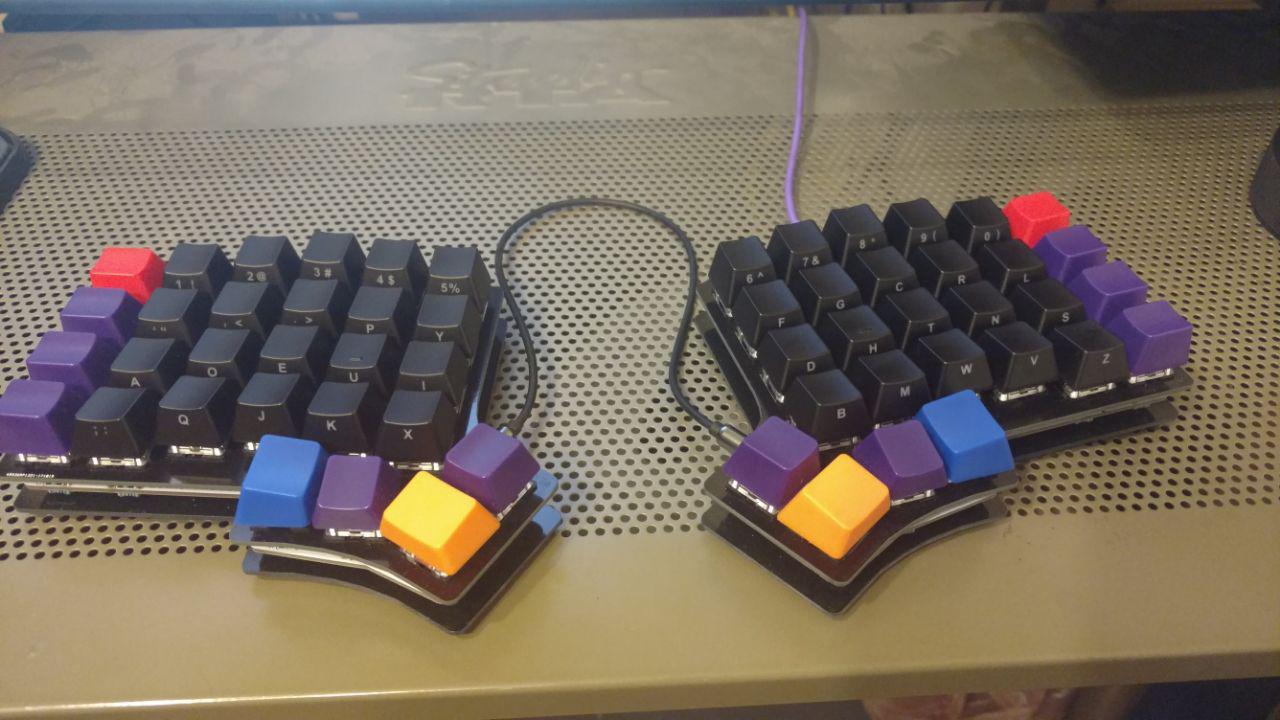

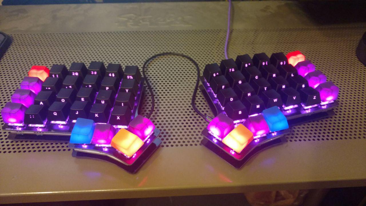

I have the bug. I just completed my first build of the Iris, a split, ortho-linear, 60% keyboard. I'm expecting my keycaps to be delivered today. I've already bought the PCB and case to make another one as parts aren't always in stock. This is a relatively new keyboard, (has only been out for a few months) so the supply/demand has yet to be ironed out.
I promise to get pictures on here once I get my keycaps put on, which will hopefully be taken tonight and uploaded tomorrow.
Price breakdown:
PCB and Plates/case - ~$50 - Found at keeb.io
LEDs and Resistors - ~$15 - The build guide recommends using 470s, but I used 220s on the resistors and 2x3x4 LEDs - LEDs Resistors *note: There are several choices. I got one that had several different types.*
Pro-micro and Header Pins ~$45 - I bought SparkFun pro-micros due to the high reviews they got. I've had friends spend $6-9 dollars on pro-micros and they ran into issues with ports breaking off after a single plug/unplug. These are about $20 each, (need one for each side) but they are sturdy. I'm sure that's not the case for all the pro-micros, but I want this to last and don't want to have to desolder/resolder a new pro-micro if one decides to break. Pro-micro
Switches - ~$20 - Gateron blues/browns. Browns for my alpha numeric, and blues for my modifier keys (shift, function, space, etc) Switches
Key caps - ~$70 - Split purchase between WASDkeyboards and MAXkeyboard. WASD had the color's I wanted, and MAX had the pricing and printing options I wanted.
Solder/flux
Add shipping/handling to this and I ended up around $215 or so.

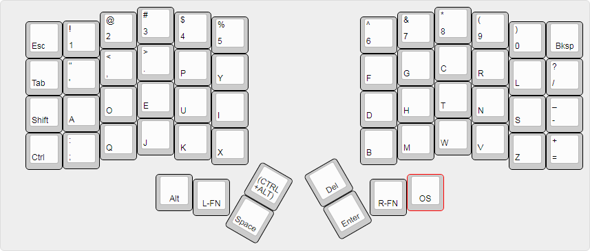

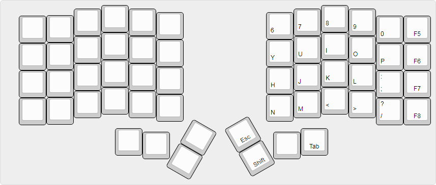

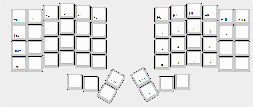

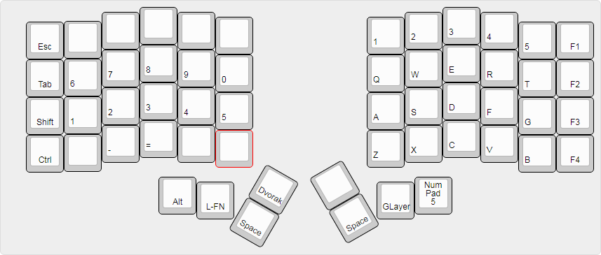

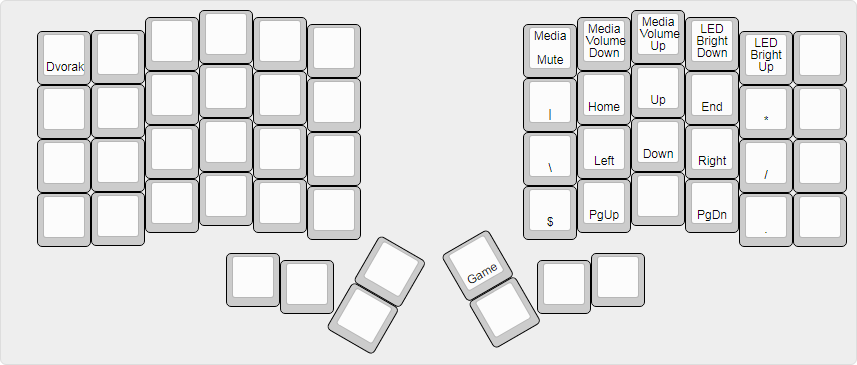

It'll make more sense once I upload some pictures. I've typed in Dvorak for about 12 years, but I also game quite a bit. I got pretty tired of some games not allowing you to change the keymaps, so I built a gaming layer that removes that problem. I'm also left handed, so the games I can remap the keys, I usually bind on my 10-key. This keyboard isn't your standard, so I built a 10-key on a different Layer, and keep in mind that this is still very new to me, so I'm still tampering with the layers.
Base Layer: My Dvorak layout.
Left Layer: Keys to allow for the 10-key while pressing the L-FN key.
Right Layer: Keys to allow media and arrow keys while pressing the R-FN key.
Game Layer: Left side of a standard Qwerty keyboard, with a few adjustments based on games I play.
GLayer: Right side of a standard Qwerty keyboard while pressing the R-FN key to allow for the rest of the Qwerty access.
Still a heavy WIP, but it's working so far. I'm pretty happy with the way I have things so far, but I know I still have room to adjust things. I also didn't include some of the less used keys like Print Screen and Pause Break, or Num-lock(Don't need that one anymore) Also, I have the ability to double tap the Shift key and it becomes a caps lock toggle. If I press and hold it, it's just the Shift key, so there are a lot of things like that, that I still need to get a feel for. I love being able to tweak things, somewhat simply, by modifying the firmware and reflashing my pro-micro.

Thanks for posting about your setup. How'd you make those spiffy layer layout images?
Also, if you don't mind, it would be cool if you updated your post to add links to the various components you purchased for your setup, so everyone could see the individual parts that make the whole.
http://www.keyboard-layout-editor.com/#/ I had to modify the Ergodox Preset to look like the Iris. I'll take the time to fix my original post to update it with links to the sites I shopped for parts.

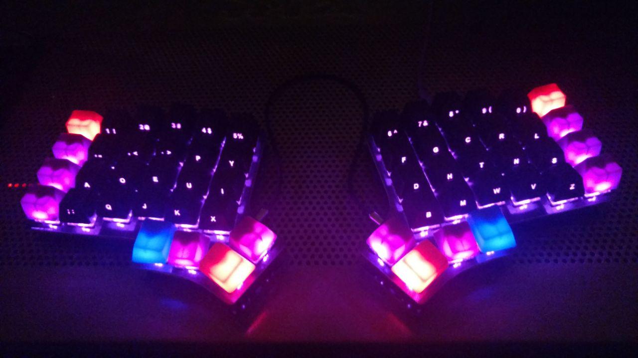

But without further ado... here's my first homemade keyboard.
Introducing the Iris:
With the lights out.
LEDs off.
I had some more pictures taken, but apparently my phone decided today was the day to dump all my camera pictures.
Re: Mechanical Keyboards
« Reply #40 on: January 19, 2018, 10:33 AM »
^ looks really good  :-*
« Reply #41 on: January 19, 2018, 09:55 PM »
Looks beautiful  :Thmbsup:

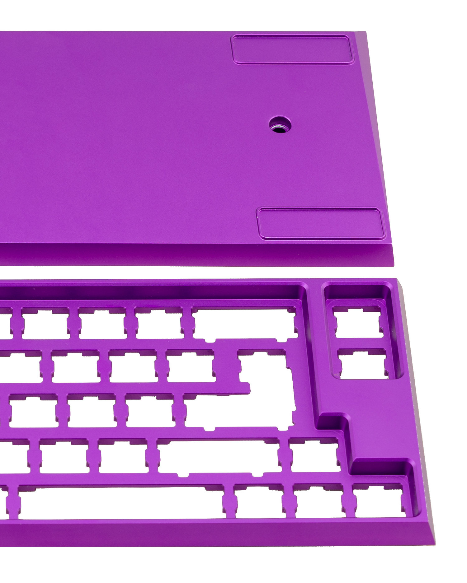

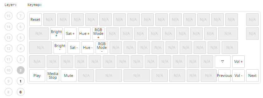

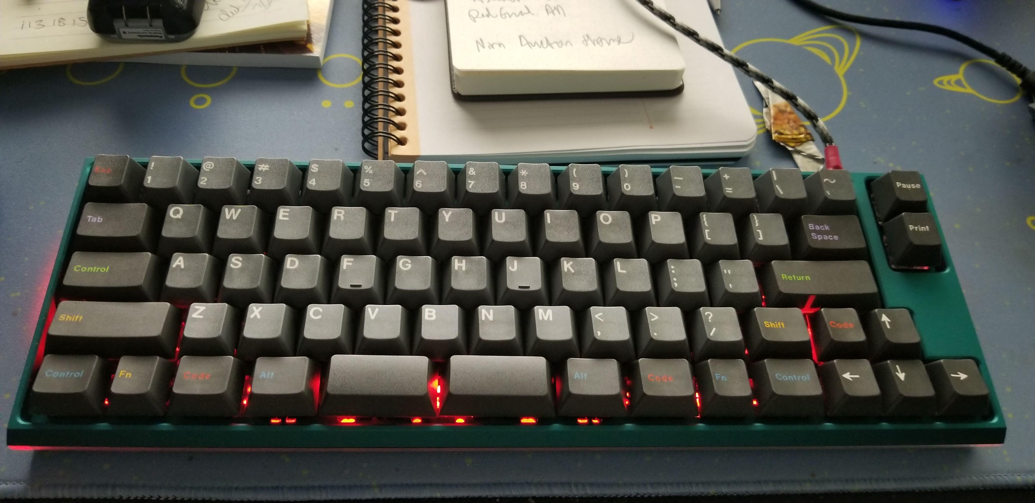

So for me, my layout preferences are a constantly evolving thing, iterating on what I like, and removing what I don't.  My current daily driver.
It's a new Clueboard v4.  I've been really liking the Clueboard for the 'superplate'.
Going a bit into the plate and its purpose:  The plate is what holds the switches in place and can be made out of many different materials, and be mounted in many different ways.  You don't actually need a plate- you can use PCB mount switches and mount them directly to the PCB.  The result is a bit too bouncy for my case, and with how heavily I type, I just don't trust it- though there's really no evidence to support my lack of trust, in all honesty.  But the plate can be aluminum, carbon fiber, steel, brass, bronze - or really any semi-rigid metal - with varying degrees of support, resistance, and aesthetic appeal.  Similarly, there are many different ways to mount the plate in the case- the simplest being a sandwich case, where the plate forms the top.  There are also tray mount, bottom mount, and top mount variations.  The super plate is a combination of the top part of the case and the plate.  I really like the support it gives (did I mention that I type hard?) and the feel of the mounted switches.
You can see the detail in the following image:

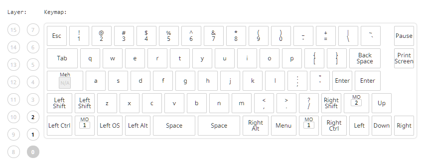

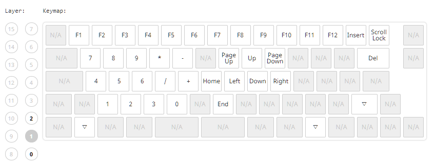

On to the layout- my current layout is merely an iteration on my prior ones, now having a split right shift, a split space, and a maximized bottom row.  My layers are set up as shown in the images below:
Layer 0Layer 1Layer 2
I haven't assigned the extra spacebar to anything but a spacebar yet; I've been trying it out, to make sure that I don't hit it in normal practice as I theorized.  If I don't, I'll probably make it backspace or enter, and hit it with my other thumb to reduce travel.
It's a really interesting hobby- and I do believe it has increased my typing speed and accuracy, and my overall productivity.  I can measure the first two, but sadly, the only measure I have of the last is my work, and considering that it's just changed a bit in scope, I don't really have a good measure.
Ask any question that you will, and I'll try to answer :)

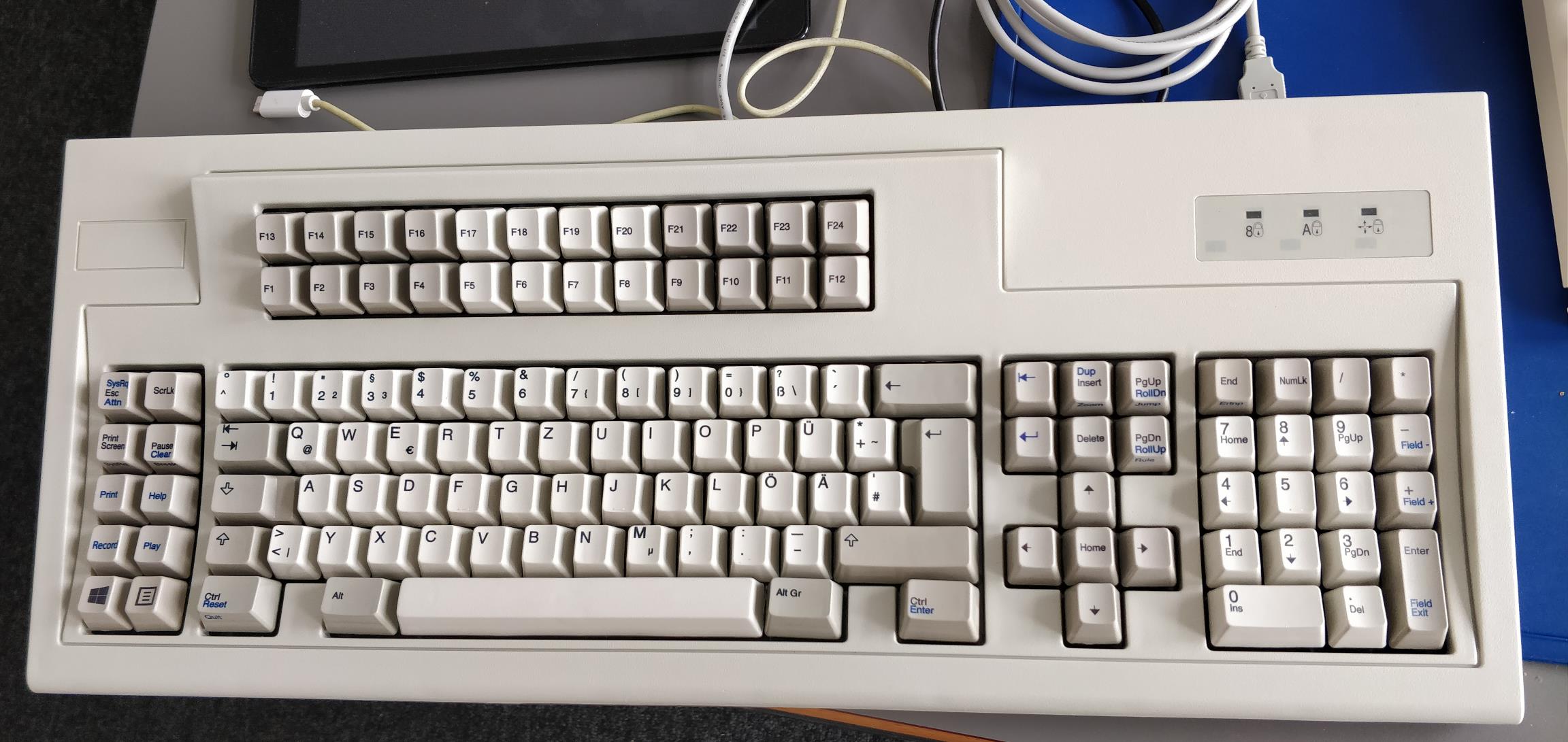

I bought a new toy. :)

You might like this site: https://deskthority.net
They deal with vintage mechanical keyboards of all types.  Looks pretty clean- congrats!
Tuxman
  • OMG not him again!
  • Posts: 2,522
« Reply #46 on: August 20, 2018, 09:58 AM »
I know deskthority, but those guys are too esoteric.  ;D
However, regarding "vintage": The keyboard pictured above was built on August 7th, 2018. There is a "license plate" on its back, stating that.  :)
« Reply #47 on: August 20, 2018, 10:24 AM »
Well, yes.  Mechanical Keyboards in general are esoteric, aren't they?
Ah... I get it.
https://www.amazon.com/Unicomp-Model-Buckling-Spring-Keyboard/dp/B01MDRT4L4
I didn't know that they were still making those.  TIL.
Well, vintage in function, if not manufacture LOL
