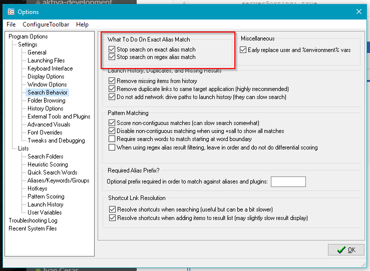

Mouser how about an option to when a result filter matches nothing revert to a regular FARR search? With that FARR would in my example above revert to a search for "x ma" everywhere and match e.g. C:\another folder\mad max.url

I have not tested it, but I think this options should get you really close to what you want.
From my understanding, you will get the alias mathces and the results of any other searches in the same list.
[Edit: added image as attachment, rather than link]

If I uncheck "stop search on regex alias match" FARR shows both the regex matches and anything else matching the pattern. So in my example above if I uncheck that option and type "x " I see the three alias results (golf, swimming, soccer) but also a lot of other things. The problem here is that with a conveniently short first group alias "starter string" ("x " in my example) a lot of other filenames will match (have an x and a space) and clutter the list.
The option I want is "stop search if (regex alias match and (results filter not enabled or results filter match) )". Though when I spell it out it that way it sounds like a pretty niche option I must say.  ;D
