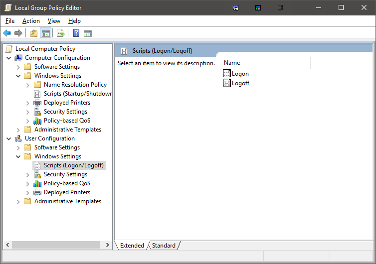

You could use Devcon with a Logoff/Logon script under Group Policy Editor:
Logoff: devcon disable "@ ....."
Logon: devcon enable "@ ....."
You need the Hardware Instance ID Device Instance Path, (eg. see this example), obtained from Device Manager.

3. in LGPE / local computer policy / user config / windows settings / scripts (logon/logoff) i would put in scripts you listed with HW ID(s) i looked up.
so i would then NOT use windows scheduler?
does the LGPE run before the programs in startup folder? (the ones that use the USB device in question). i hope so.

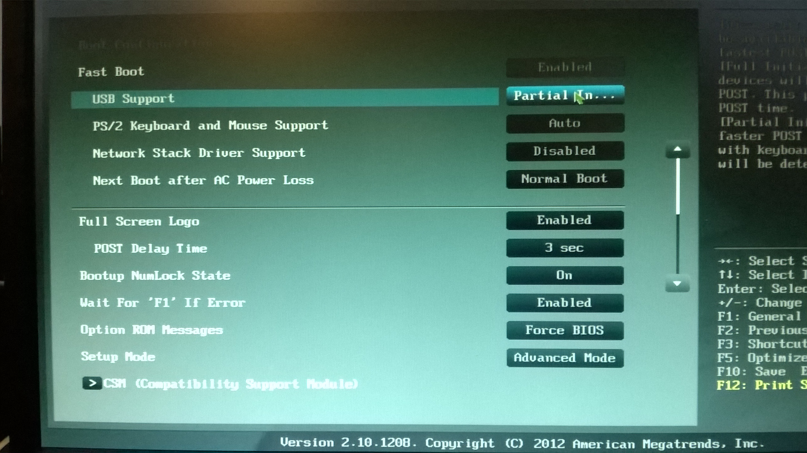

With decent motherboard models from 4 to 5 years back you have the option in BIOS/UEFI to control which (type of) USB devices are enabled at boot time. At least the Asus models in my possession do. In case you have no option to work with the snap-in provided by 4wd.
Where this kind of USB options are located in the BIOS/UEFI differs (a bit) with each make and model of motherboard, so you will likely have to consult your manual. Or identify which motherboard model is inside your computer and see if the manufacturer still provides a downloadable manual for it.
Software that will help you identify what hardware is inside your computer is: SIW  (available as freeware & commercially licensed), but there are quite some alternatives if you so desire.

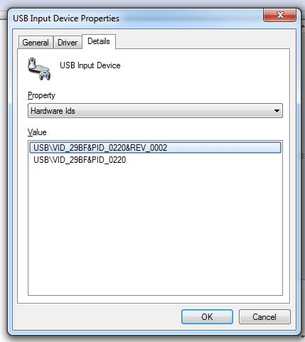

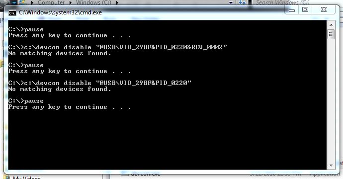

4WD
i installed devcon, placed it in c: root and wrote a small test batch file to execute the disable for the device in question.
pause
c:\devcon disable "@USB\VID_29BF&PID_0220&REV_0002"
pause
c:\devcon disable "@USB\VID_29BF&PID_0220"
pause
reports "no matching devices found"
suggestions?
i will look more into AMI BIOS options
« Last Edit: March 21, 2016, 11:12 PM by taglaser62 »

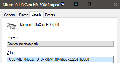

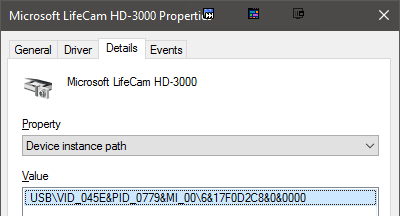

Sorry, my mistake  :-[ - you need the Device instance path from the device properties, not Hardware ID, (got my terms mixed up).
This value will change if you unplug it from one USB port and plug it in another, so as long as it stays in the same USB port you won't need to change the command once it's working.
ie. Here you can see the Device instance path has changed when I plugged it into another port:
You only need the one command to disable/enable, eg.
C:\>devcon disable "@USB\VID_045E&PID_0779&MI_00\6&5372223&1&0000"
USB\VID_045E&PID_0779&MI_00\6&5372223&1&0000                : Disabled
1 device(s) disabled.
C:\>

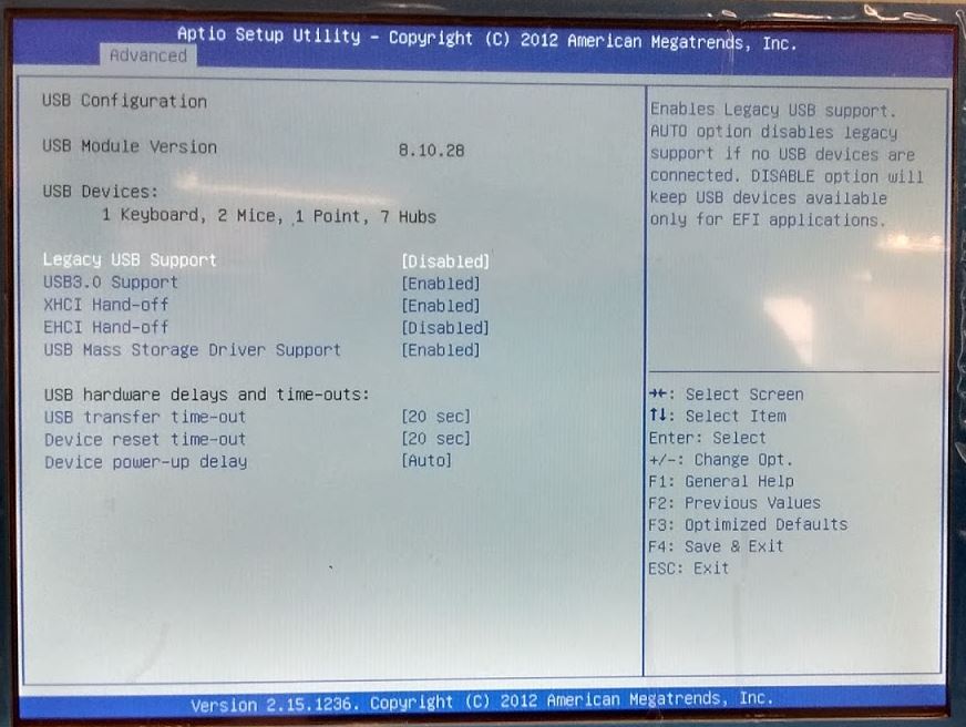

was a bios issue.
needed to disable legacy usb...
rebooted many times today with no problems!

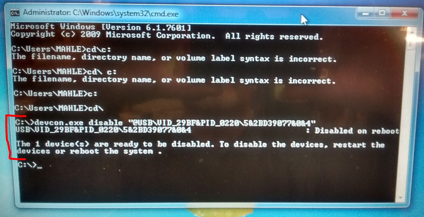

with devcon.exe in root directory and using cmd i ran devcon.exe disable "@... see attached. ran okay and asked me to reboot.
i rebooted as prompted and had EZB USB unplugged. booted okay.
then i plugged EZB usb into port and ran EZB sw which did not find the EZB hw which is what we wanted to happen.
i also tested to make sure EZB sw saw hw in another port.
i then, leaving the EZB USB connected to the disabled port, rebooted, but windows would not boot.
basically same result as before devcon was run.
help!

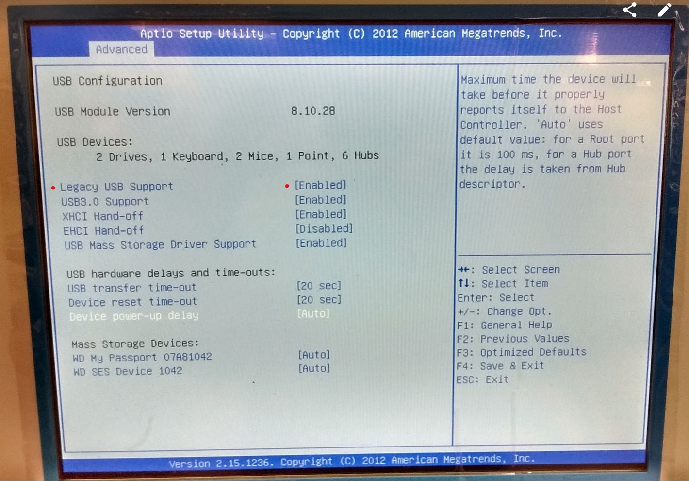

From the images you provided I see you have a PC with an older AMI BIOS. More modern versions of BIOS and/or UEFI allow for much more fine-grained control about which USB connected devices can be disabled at starting the PC.
Mouses and keyboards that are connected through USB have no need to use for the latest incarnation of the USB protocol and still chug along with the lowest version of USB they can get away with (which usually means USB 1.1). That USB standard is more than adequate for those devices, mouses only send relative position data, clicks etc. Even a fast typist cannot type fast enough to saturate the data bandwidth provided by an USB 1.1 port.
The 'USB Legacy' option in your BIOS apparently means that USB 1.1 devices are disabled at boot.
Modern versions of BIOS/UEFI are able to distinct between USB devices and allow keyboard/mouse to be enabled while other USB devices are not.
Not sure if there is even a BIOS upgrade for your specific motherboard model available that gives you more fine-grained control over USB devices. Upgrading a BIOS isn't very difficult and doesn't take much time. However, if anything goes wrong during this BIOS upgrade procedure, there is a distinct possibility you brick your computer.
Some older PC's have some kind of backup BIOS chip on their motherboard, but most PC's only come with one of those chips and most are soldered directly on the motherboard.
Mess it up and you can look forward to time-consuming and (very) costly repairs. If you are lucky you can get a new BIOS chip from the manufacturer or you need to hunt for
a similar chip on a spare/(not too) broken motherboard (exact same make and model as the one you have). Replacing the old BIOS chip with the new one requires some expertise as well.
This is the option in the BIOS/UEFI from my 3 year old PC that would resolve your problem.
Unfortunately your BIOS doesn't seem to have it.
