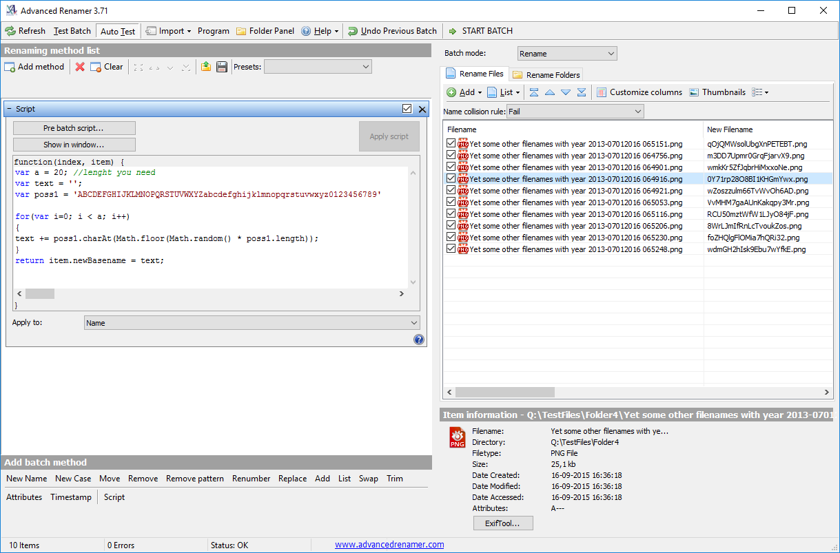

p.s. also possible using a script within Advanced Renamer
« Last Edit: March 10, 2016, 06:22 AM by dcwul62 »
