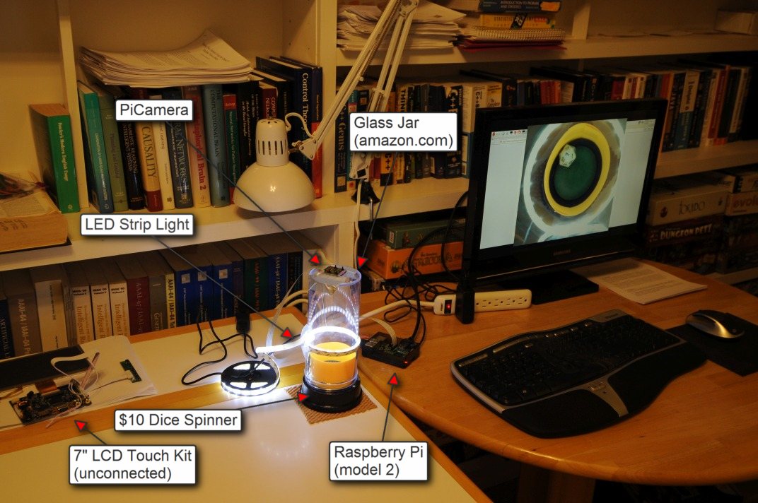

My Raspberry Pi Die Analyzer Test Bench:

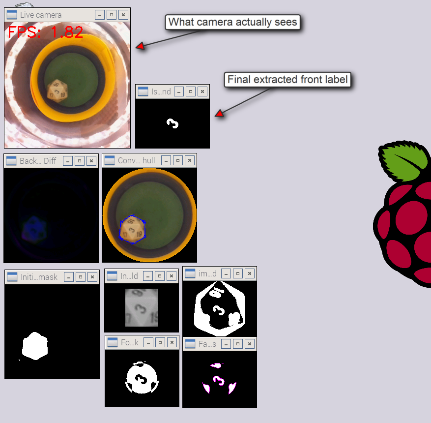

Software running on rpi:
ps. for what it's worth, using this software as a benchmark, my desktop pc is about 20x faster than the RPI2.

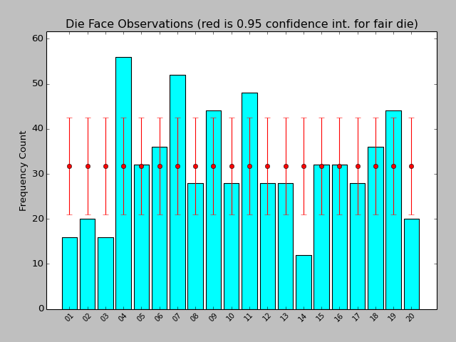

Sample graph from the program.
NOTE: This data is not real, i don't have automated roller working yet.  I hope to have automated rolling working in next 10 days.
The red lines you see show where the data for a fair die should lie with 95% confidence.
If these were real results, this die could be confidently labeled as NOT fair.

A real report from real rolls:
This die looks like 5s come up more than they should (and 1s less)..

In the image, what exactly does 'red is 0.95 confidence int. for fair die' mean?
Does it mean that within the range of the red lines in the bar-chart means you have 95% 'confidence' in the results?
Damn, I see you already answered that in your previous post. So, this die is not fair, due to the results for 5 being too high (took me a while to figure that out :-[ )
What is means is that if you repeated this experiment over and over with a perfectly fair die, rolling this many times, you would expect the counts to fall within those red bars, 95 times you ran the experiment out of 100.

So, this die is possibly fair?
I'm writing a little paper on this project and i will discuss the nature of these statistics a little bit.  These probabilistic things can be tricky to wrap your head around.
No matter what experiment you do, its ALWAYS going to be possible that the results came from a fair (or unfair) die.  The best you can do is say how unlikely it would be to get results like these if the die was fair.

So one aspect of the statistics im very wobbly on is the relation between the chisquared statistic and the confidence intervals for the histogram bars.
The chi-squared is evaluating how likely the complete set of results came from a fair die.  For a fair die, the frequency counts from all bins (die faces) should be roughly equal.
The histogram confidence intervals are evaluating each bin independently according to how likely the counts would be in that range.
Im not sure how to talk about how these statistics differ in their estimates..
The chi-squared suggests that this distribution wouldn't be surprising to see from a fair die, while the histogram confidence intervals seem to suggest that it would be..  I don't know if that means I'm calculating something wrong or misusing some statistic..

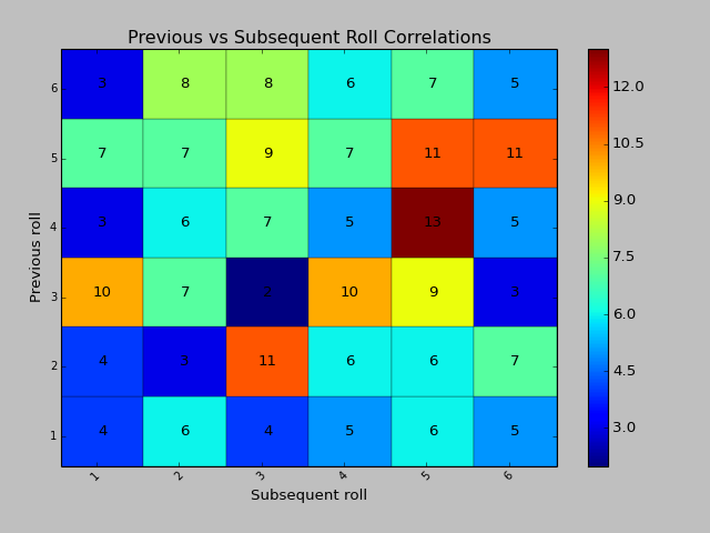

Another kind of statistic you might want to look at when analyzing a die is whether there are patterns between two successive rolls (e.g. do 6's always follow 1s?).
For that we can use the same statistics as shown above when counting frequencies, but looking at a separate histogram for each die face, counting the subsequent die face frequencies.
And for pure visuals, a heatmap can help show unusually high/low frequencies of certain previous-subsequent die roll pairings:
Note: This chart has too little data to be truly informative-- it's just meant for illustrative purposes.
