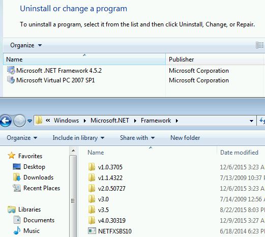

Why would they need to support 4.0 directly? 4.5.1 gets upgraded to 4.5.2, and 4.5.2 includes 4.0 just like 3.5 includes 3.0 and 2.0. So they're not really orphaning it, their just bundling it in with the latest version to limit the number of updates that need to be futzed with.
Re: Developer PSA: Support Ending for the .NET Framework 4, 4.5 and 4.5.1
« Reply #3 on: December 12, 2015, 05:41 PM »
[attachment 1 not found]
Because of software and development.  If you target 4.0 in your applications, then you are using an unsupported version.  Much of our infrastructure in the company I work for is using 4.0.  Most of the software I have linked from the site also uses 4.0.  Unless I recompile it for 4.5 and re-release, it's unsupported.  Even if the assemblies for the versions are in the same place, they are not the same version, as you can see by the linked assemblies a build is targeting.

Um... Okay, but just because they're dropping support for a specific install version of a framework doesn't (appear to) mean it's no longer usable. It just means - or at least appears to mean - that you need to be running a supported version that includes it.
Quote from: the article you linked to
You may have one or more applications that are currently targeting a .NET Framework version that will no longer be supported. You can run those applications on a later .NET Framework version without targeting a new version
I would read that as meaning if you call MS for support on an issue with - an as installed version of - .NET4.0 they'll tell you that you will have to update it to v4.5.2 - which includes 4.0 - before they will help with anything. So if you're compiled to run 4.0, and have 4.5.2 installed (which includes 4.0) there shouldn't be any issues.
